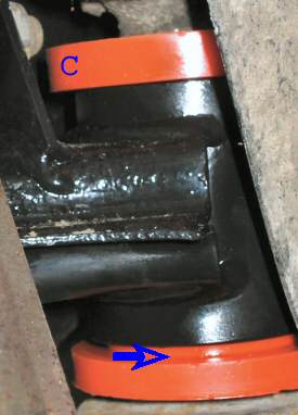

        like this but 1/4" ? if so, then you need to order 33 33 1 127 496 called a stopper.
        it sits above where the "C" is in the picture.

          Thanks for the picture xLibelle. I removed the washer from the old bushings and I put them on the new bushings.
          Anyway there is a gap just like the arrow shows in your picture. I don't understand why it should be any different, because I'm using Febi subframe bushings.

            you need to take them back off the car and do some measuring.
            measure the cup depth and see if that is even close to the cylinder that will go inside it. my guess is, its too long.

                  yes. i believe there is a metal cylinder
                  fred, when the car sits on its own feet, the springs will actually hold the subframe down, away from the car and result in a correct look. this should be a regular position for the subframe, but i havent been able to figure out what body/suspension motion or drive torque that will manipulate the subframe mount points in a vertical fashion.
                  IE bushings tend to be the same, but not as bad as you describe. since these are two-piece, they tend to seperate under force(jackstand under subframe). i got a little picky and had some discusion about design size with IE. to which i learned, if you dont like it, make it your self.
                  soapy water or not, they will move if given the room. otherwise its a design factor. but really, since the weight of the car at the wheels, combined with the oposite direction of the springs, the subframe is forced towards the ground so they might be fine anyway.
