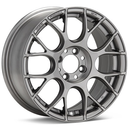

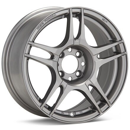

      Kosei K5R or Kosei K8R seem to offer great clearance. :)
      The Kosei K4R got discontinued two years ago and I shouted everyone back then to grab a set before they got NLA. ;-)
      I think the K8R is still a current model. As there's no feedback on this thread about that wheel, I suggest sending a retailer the fitment template in pdf file and have him test it against a wheel from the inventory.
      K5R
      K8R

        I have the 15x8 K8Rs on my car with the 300x32 massive kit. Clearance is great.

              And looking at this picture (obviously not from an e30) it seems that the Kosei K8R rim was designed to be BBK friendly. ;-)

                                Well, Tire Rack no longer has K8Rs. But I bought 1 K5R to test fit that should be here on Wednesday. I'll post back once I know if it fits.
