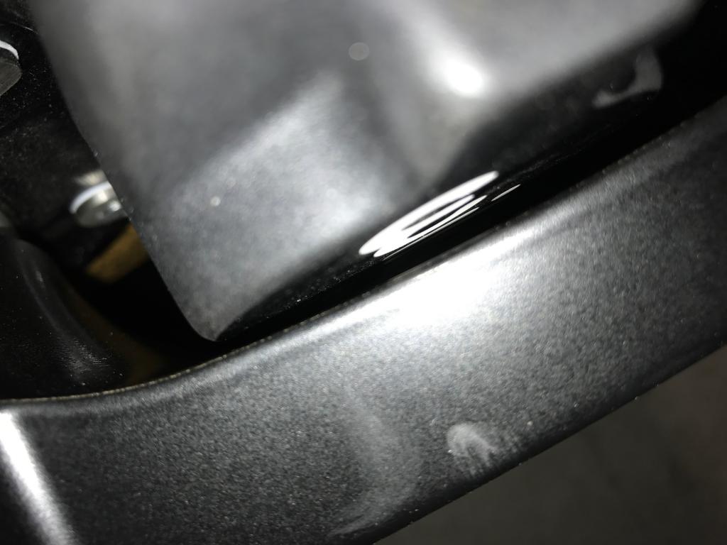

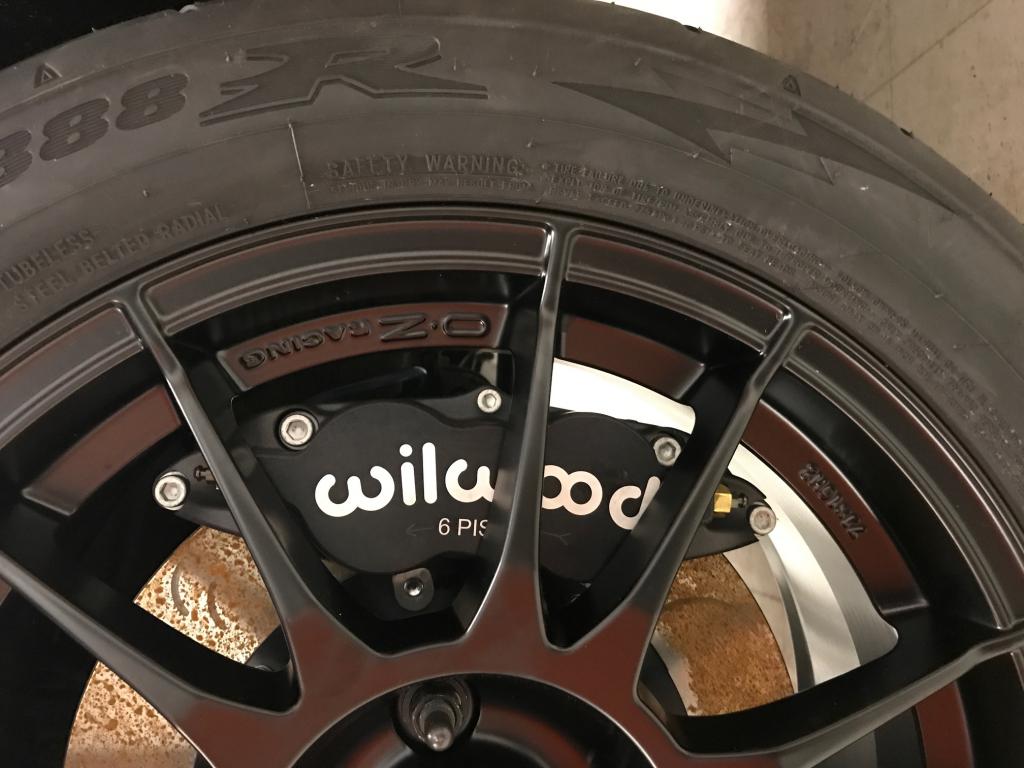

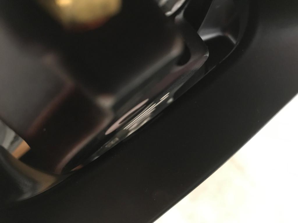

                            After scouring almost all reputable 15" wheels to fit over the 300x32 kit, due to Wilwood's redesign of the Superlite caliper, we sourced 16" OZ Ultraleggera.
                            Plenty of clearance between the caliper and rim barrel.
                            Spoke to caliper clearance is tight, but plenty of space.
                            This is mounted with the standard spacers as supplied when ordering from Tirerack.
                            -Chris
