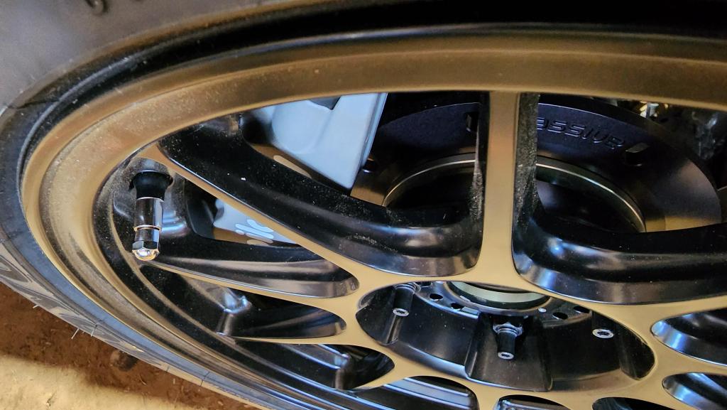

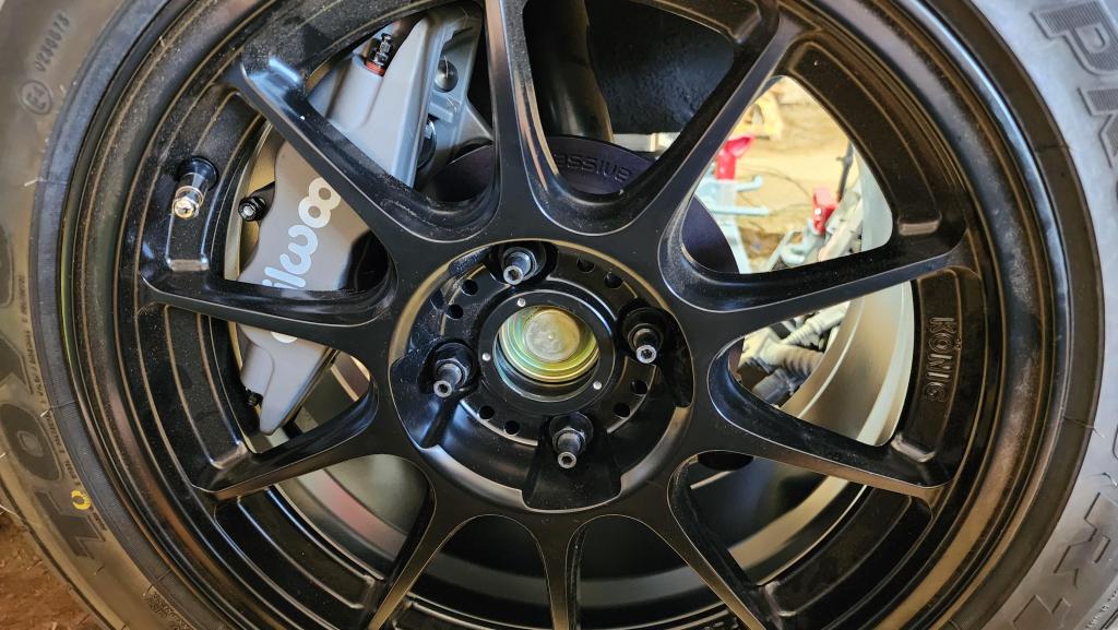

                        #341
                        Click image for larger version  Name:	dh2RKAp.jpg Views:	0 Size:	110.2 KB ID:	10070947
                        Click image for larger version  Name:	hn5eBMO.jpg Views:	0 Size:	88.9 KB ID:	10070946
                        15x8 et25 konig dekagrams fit and clear the 300x32 race kit perfectly with a 5mm spacer.

                          #342
                          This is great news! What size tires are you running?

                            #343
                            sorry for the late reply i don't get onto r3v much. im running 225/45/15 proxes r1rs

                                #345
                                I just bought a set and also confirm that these fit perfectly on the 300x32 kit front and rear. Running 225/45/15s with zero issues. I used to run 15x7 kosei K1's and had to shave the calipers down.
