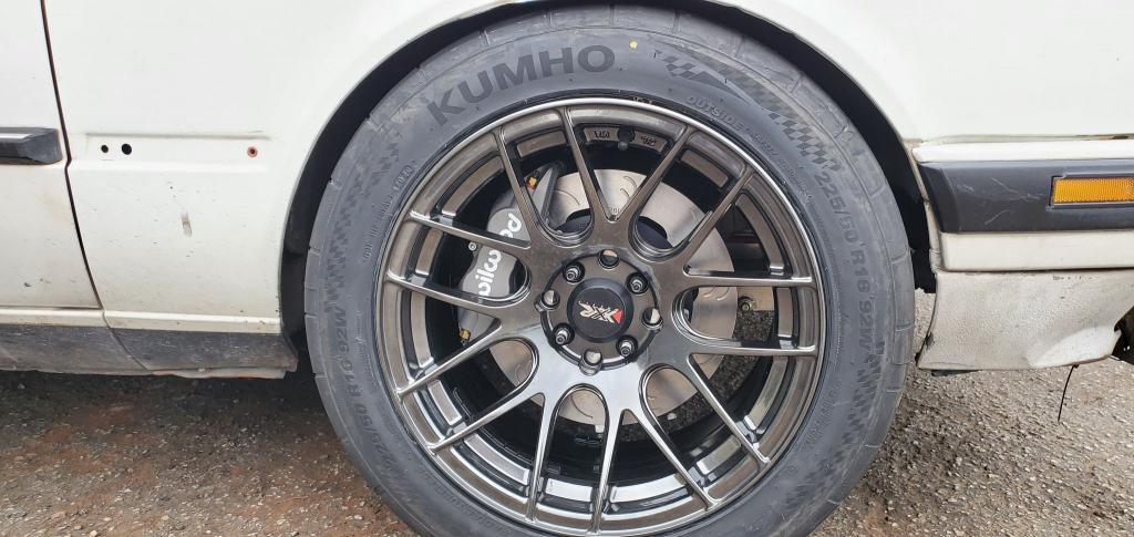

                  #323
                  Luis sent me this picture
                  300x21mm BBK w/ Superlite calipers under 16x8 XXR 530. Tons of clearance.

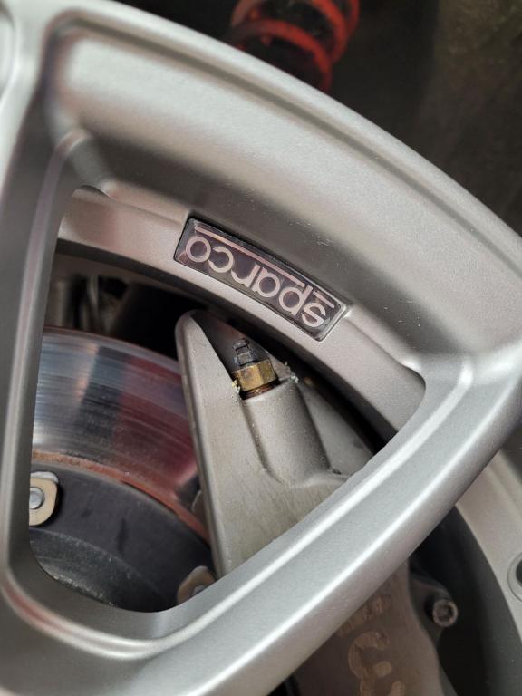

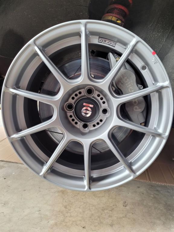

                    #324
                    The 15 inch Sparco wheels fit great. No clearance issues.
                    Click image for larger version  Name:	sparco2M.jpg Views:	0 Size:	64.4 KB ID:	9990749
                    Click image for larger version  Name:	sparco22M.jpg Views:	0 Size:	46.8 KB ID:	9990750
                    • Massive Lee
                      • Sep 2006
                      • 6785
                      #325
                      Wow. Yup. Very nice rims. Over the years, some great wheels become NLA, and new wheels get offered.
                      What width of wheels are they? 7" or 8" wide
                      Is that a front 300x21mm Sport kit or 300x32mm Race kit?
                      Let us know.. ;-)
                      Lee
                      massivebrakes.com

                          • Dingg
                            • Apr 2018
                            • 8
                            #328
                            Let us know.. ;-)
                            Lee
                            Sorry, should have put that info in the original post.
                            The brake kit is the 300x21mm sport kit. The wheels are the 8". However, with the 8", there was clearance issues with the strut, so you would definitely need a spacer.
