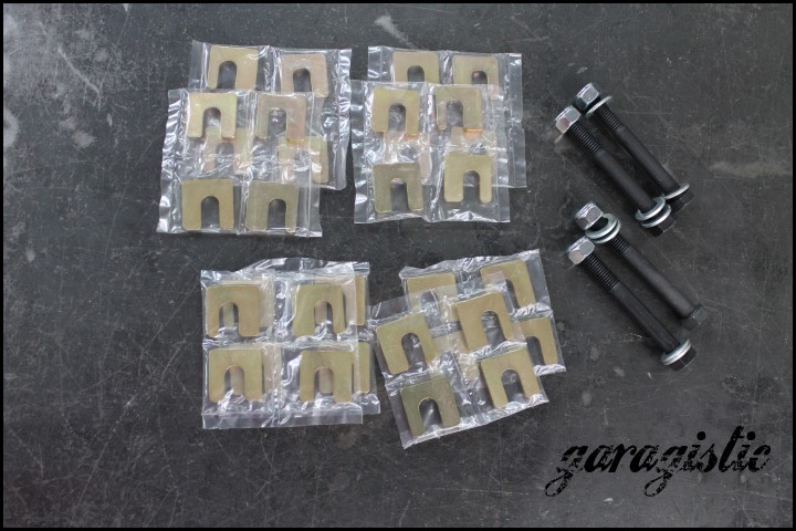

      Thanks for mentioning our Shim kit. Its a new product but a simple solution to the common problem of e30s coming out of alignment. Link here:
      https://store.garagistic.com/incremental-camber-toe-shim-kit-e30-z3-318ti

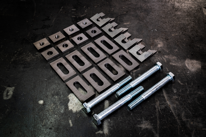

        I've had the slot style ones move on me multiple times. Once I get my ride height fully set on my car, I intend to weld them in place. If I had to do it again, I'd get the IE Posi-Lock style ones.

            So... here’s my rundown why they move.
            Im sure most don’t get the slots that parallel, and going from a hole, you now only have 30% clamping area at best.
            A lot of the Rtab sleeves are aluminum which with 30 % of the clamping area will mushroom the sleeve letting the clamping torque lower in result the eccentric moves.
            A nice precision slot, a harden steel sleeve, a honker of a wrench and that should remedy it.
            With the variance of trailing arms and subframe I’ve steered myself towards the IE serrated setup, you get about twice the adjustment. But nothing is bolt in...
            I wish some one would make the old dinan ones again!
            @Zakspeed_US
            • SkiFree
              • Jun 2011
              • 2766

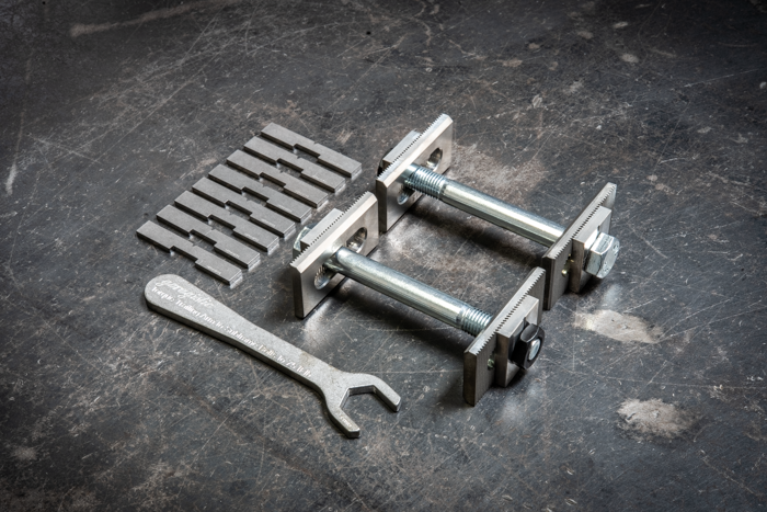

              The IE Serrated Camber and Toe kits are certainly the best way to go. Knowing how much Condor steals other shops designs parts though... it's only a matter of time before they copy yet another product (namely the IE serrated design).
              ADAMS Autosport
              • moatilliatta
                • 6152
                I wouldn’t be mad. At least then maybe the could design them better and have a better supply chain. The threaded hole in the serrated part needs hardened, first batch of them I bought were 2 sets of different serrated pattern.. so glad I caught that.
                Best to drill and weld a nut in the back of them..

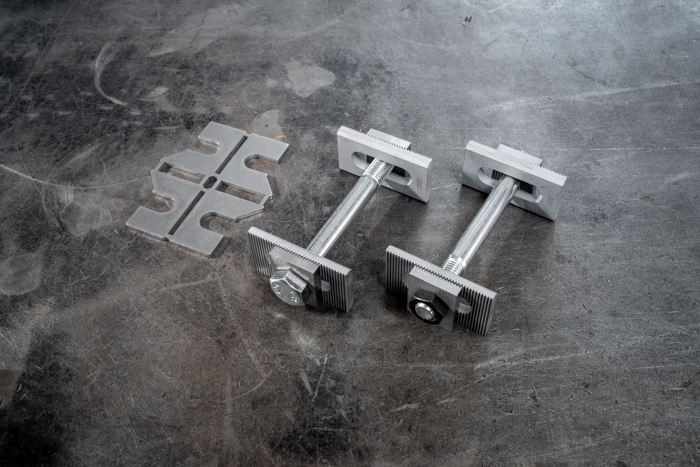

                          Garagistic just came out with serrated kit.
                          BMW E30 SERRATED CAMBER AND TOE ADJUSTMENT BRACKETS Overview Our Garagistic serrated camber and toe adjustment brackets will allow you to set the rear alignment with the utmost confidence. Similar to the tried and true eccentric bolt method of adding camber and toe adjustments to the E30's rear subframe, these serrated
