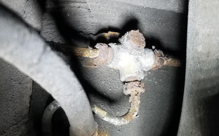

    Hey E30 gurus, can you please tell me what I need to know when replacing my hard brake lines? I'm doing a rear subframe refresh, and some of those lines are pretty corroded.

                    For my project to replace rusty brake lines, I had to cut off the pipe on the left side of the T-fitting in my pic above. That pipe goes all the way to the engine compartment, and I didn't want to redo the whole length. My bending skills suck, so I cut off the rusty end and connected the new copper to the OEM steel with a union fitting. The bitch part was making the bubble flare on the steel end. Cost me weeks of trying/breaking different tools to finally get it done.

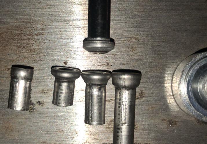

                    • plmichal
                      • 718
                      Using a Cal Van tool to make bubble flares on stainless steel hard lines. The ones on the bottom are my failed attempts so far. The one on top is an OE BMW hardline brake line, that’s what they’re supposed to look like. I’m going to try a few more times.
                      1990 325is Brilliantrot/Natur
                      • fitswell
                        • Nov 2008
                        • 224
                        Unless you are a pro, I would strongly advise against SS if you are tryin to flare yourself. Just had all my rear lines done in SS and would very likely go with Cunifer/Nicopp if I was doing it again. Cost is similar and so is the performance.
                        Out of three shops in my area, only one did a decent job with the SS bubbles. They didn't come out perfect but good enough. One of the shops gave it a try but couldn't do it so I wasted some time just going back and forth. If a hydraulic shop is having issues then its not a good sign. Also, it was a real PITA to do final adjustments when installing the lines in the car. SS tube is a really tough material to work with without proper tools. Lastly, if you are using SS lines, get SS fittings as well, obviously.
