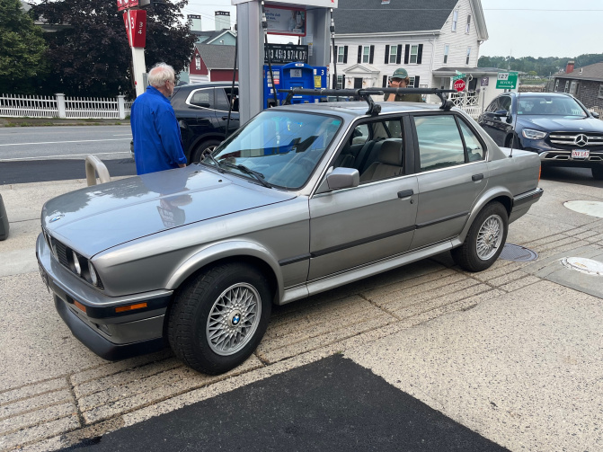

          We just finished lifting my son's 89 ix sedan to fit Pirelli ATR 205/70R15's on stock ix basketweaves. They're about a 26" OD tire vs the stock 24" tire, so we added 1" of lift for clearance. That involved:
          1. Replacing 6X front strut press-in studs with new M8X1.25 X35mm studs, same for 4X rear upper shock mounts.
          2. adding 1" of spacer between the front strut bearings/rear upper shock mounts and the body. We cut this out of 1/2" thick PP/HDPE boardstock, aka Starboard
          3. adding 1/2" spacers of the same material on top and bottom of rear springs (1" total)
          The only issue we had to work on was that the top inner corners of the tires rub on the bottom of the front strut lower spring seat. ix front strut rebuilds especially on this one will be involved, so hopefully this lasts a while. We ended up grinding off some of the front seat and adding 5mm wheel spacers to get a little more clearance.
          front suspension on the ix is different from an RWD E30, so you might have issues clearing the wheelwell in the back- but those tires just squeak in there!
          Rides/drives nice so far.... time will tell.
