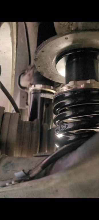

    I have a 91(92) 318i convertible. Previous owner installed the BC racing coilovers. The rear spring rate appears to be 160lb based on the part number and behavior. I have raised the adjuster all the way up(or down) and the car will settle right back down on the tire. Rate seems preposterously low.
    Question 1 - what is the recommended spring rate for a convertible? Would like it lowered but not the tire sitting on the lip (this is a street car)
    Question 2 - why is it so hard to find manufacturers spring rates for these cars instead of just marketing style naming?
    Question 3 - does anyone sell rear springs only for the BC setup? Ideally, I would call a vendor and get a BC replacement spring with a different spring rate and swap it out, but BC doesn't list part numbers or spring rates. Again, seems absurd.
    Not uncommon in even the muscle car world to just go to the catalog and get springs by length, diameter, and rate. Am I missing something?
    Thanks for any and all help. Pretty new to the e30 world.
    Edit - I'm checking the spring part numbers against swift spring website.... 62-160 is the part number for the front spring. but that appears to be installed on the rear of the car. so, likely the spring is too short. But it should be a 450lb spring.
    According to the same site, both springs for the kit are 8k / 450lb springs. does that sound right? or should I get a higher rate for the back?

      Just confirmed the rear spring part number 62-120-008, which is the right spring part number for the kit. Which is a 450lb srping.
      The spring sits on the trailing arm, not a true coilover in the rear. The kit has adjustable spring perches which adjust about 2inches. There seems to be no difference in ride height even with the spring perch at its tallest setting.
      Still very confused why I cannot raise the rear of the car, even when adjusting the spring perch.
      Any suggestions for replacement springs? The shocks themselves seem to be fine.

          Agree, does not make sense. This is happening on both sides. No cracks anywhere. I take the spring and perch out to adjust height and then reinstall.
          My theory is the spring rate is way too low and is collapsing.

              Here is a question - does the BC spring adjuster go on the top of the spring or the bottom? I don't have a set of instructions. The adjustable spring perch is on the top and I left it there. But, I see installation videos with the perch on the bottom. In theory, should not matter, right?
              The nipple is still there.
