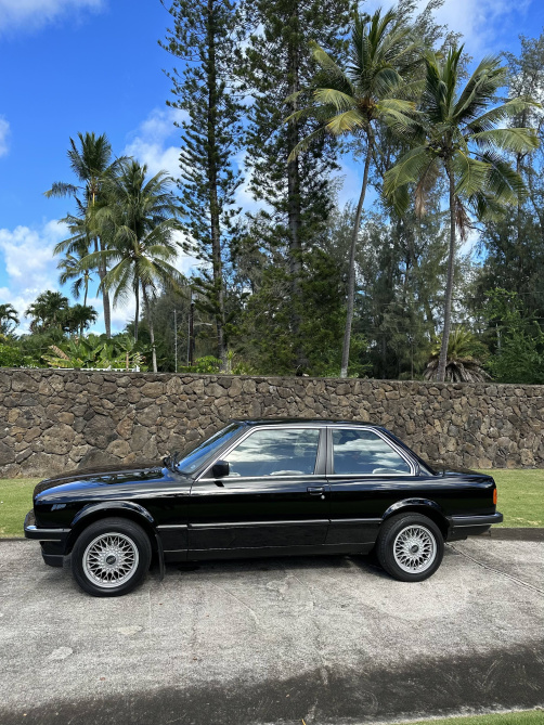

    I've gone through the threads and looked online but haven't found an answer yet.
    I'm getting ready to install H&R Sport Springs and Koni Adjustables on my 84 ETA with 15" Euroweaves. What's the best front upper spring pad size and rear lower spring pad size to give me an even drop? Realoem shows 3 and 9mm for front and 5, 7.5 and 10mm for the rears. I want to stick with OEM spring pads and not the adjustable ones.
    Also post a pic if you have an early model on Sport Springs
    ​ Click image for larger version

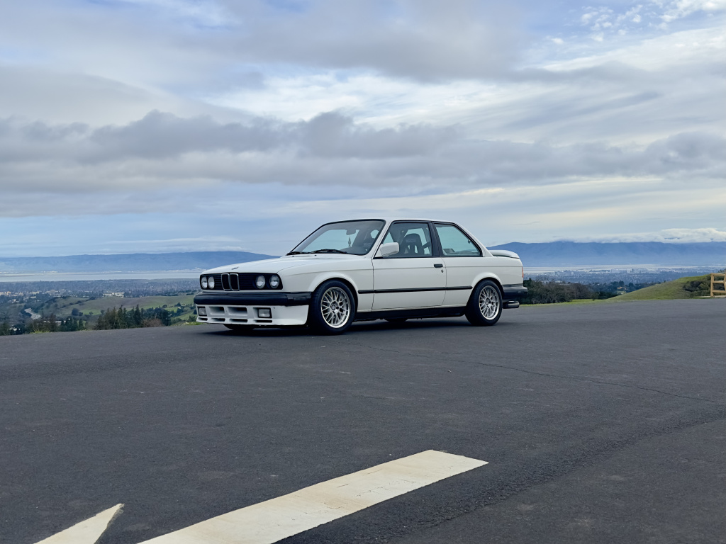

    This was a tough question for me!
    I actually had to go dig through old forum posts and my build thread pics to figure out what spring pads I used in the rear.
    Early model with taller rear arches.
    No wheel spacers in the "brown car" pictures.
    5mm front & 20mm rear hubcentric/wheelcentric spacers with the "silver car" pics.
    H&R Sports w/Billy Sports (1/4 inactive coil cut from front springs)
    E90 Drop Hats (10-15mm drop)
    318i 3mm Front Spring Pads (6mm drop)
    Used the thinnest (5mm) spring pads in the rear (top & bottom) which deleted the bump stop.
    15x7 BBS "Euroweaves" [et-24] w/ Dunlop Direzza dz102 (205/55r15)
