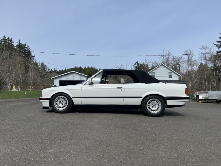

      Fronts came together fine, but even with the adjusters all of the way at the top of the threads, the spring falls a few inches below the upper seat at full droop.
      • ehrawn
        • Aug 2023
        • 216

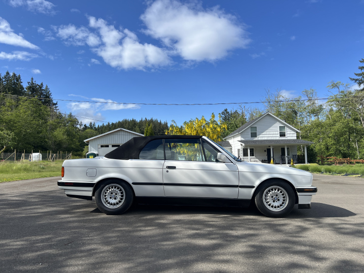

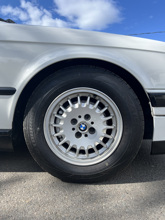

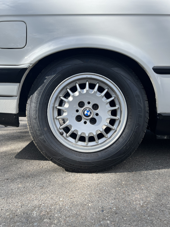

        Here’s the before and after, adjusters all of the way at the top on all four corners. The rear is about an inch lower, and the front almost 3 inches (!) lower.
        Click image for larger version  Name:	IMG_5985.jpg Views:	0 Size:	195.9 KB ID:	10136937 Click image for larger version  Name:	IMG_6144.jpg Views:	16 Size:	172.1 KB ID:	10136858
        • ehrawn
          • Aug 2023
          • 216
          I’m going to need to address the front height. With the collars all of the way up on the strut housing, I don’t have any adjustability. I’m not sure if I just need longer springs or if a tender spring might be able to fill in some of the extra space.
          • ehrawn
            • Aug 2023
            • 216

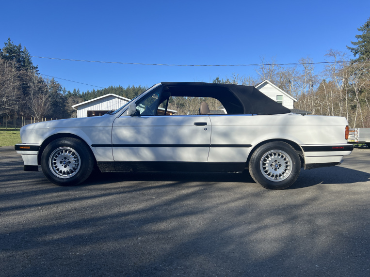

            Ground Control hooked me up with no cost exchange for 8” springs. Ride height/ adjustability range looks much better. Took it for drive around the block. Steering feels sluggish, so an alignment’s in order.

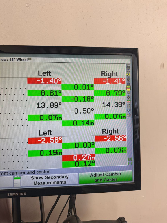

ID:	10139888 Garage alignment done and it drives sooo good.

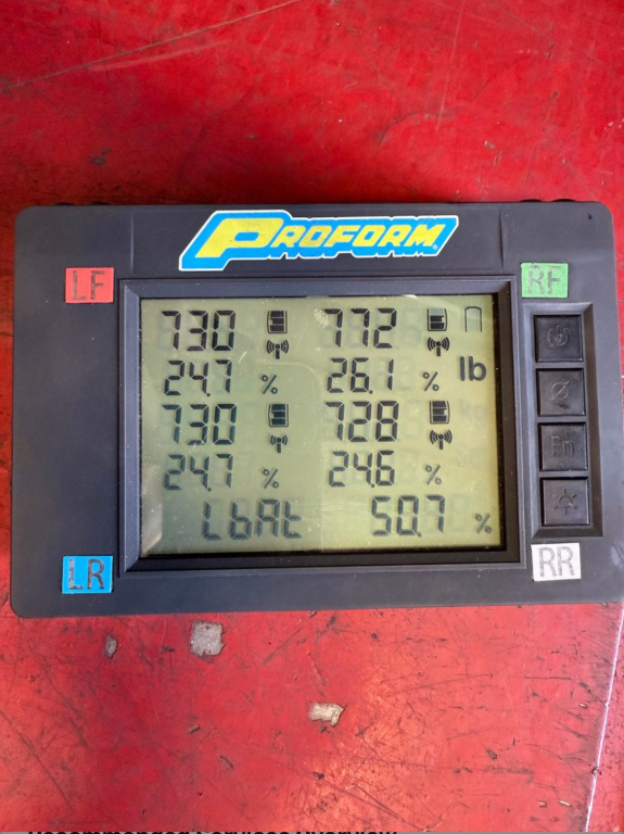

                Corner balance and alignment results. Drives like a dream.

                          I forget how good bottlecaps can look. Perfect stance too! What are the measurements now from the ground to fender for front and rear?

                              Originally posted by Mike36
                              I What are the measurements now from the ground to fender for front and rear?
                              6” behind the front tire. 6.5” in front of the rear
