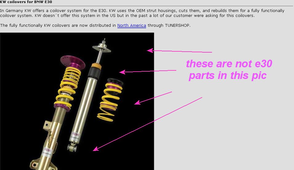

                    anyone else with the KW?, looks like a good option. Does the V1 come with camber plates? I like how the housings are already set up.
                          Unfortunately NOT true. The housings are not set up. Pretty much every KW picture on the internet, both in the US and Germany, is the wrong pic. Most e30 pics are of a Golf mkV kit (even though it says e30)
                          Originally posted by KW Website
                          PLEASE NOTE: If you are ordering E30 coilovers, we will require your old struts on an exchange basis due to the BMW E30's strut with insert design. This can either be done by providing struts at the time of order, or by paying an extra £340 deposit which will be refunded upon receipt of your old struts. Please just ask if you'd like clarification on this.
                          That is about US$ 550 for a deposit, for your struts to be sent to Germany. The freight cost is about US $170 to get there, and about $300 to get here, and I heard it takes about 6 weeks.

                            • Hellabad
                              • 807
                              This is why y'all are confused. Its not your fault. All of the people trying to sell KW, don't have any pictures of the parts they are trying to sell (?), so they just use a pic from a different car.
