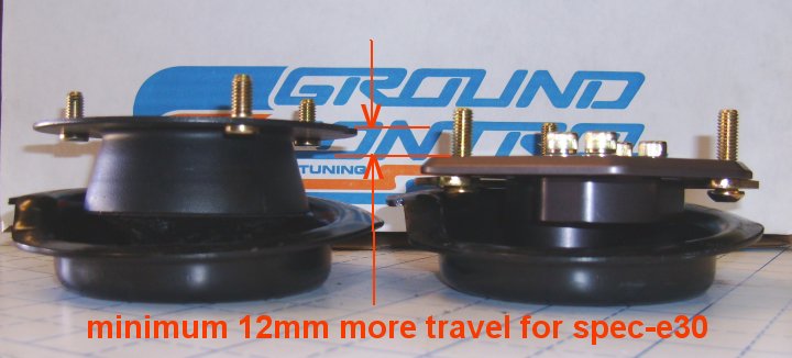

    Don't do it. Either make drop hats, or buy GC camber plates.

        great so many people say different things. i knew i would run into this problem. i can't find drop hats and everyone says they suck. a hole coil being cut off is way to low. gc camber plates are way to pricey for a 1/4".

              Less than one coil will not be much of a drop at all, and GC's plates are like 23mm shorter than stock so the drop is almost an inch. I have cut aftermarket springs before and I definitely regretted it shortly thereafter. The rears felt fine, but the fronts were awful. Would not recommend it.
                  It's actually more like 12mm.
