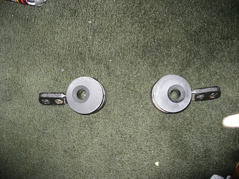

    whats the easiest way to get the old ones out and where do i put the offset hole in the new ones?

    idk about gettin them out but, there is a arrow or line to line up wit the new cab i think it points in i cant remember

      Use a hack saw to cut the outer metal ring of the bushing, there will be an arrow or a mark on the new bushing that you must line up with the mark on the lollipop.
      Here's a picture to kinda give you an idea.

        awesome thanks alot. good pics that should work out fine

          Regardless of whether the bushing is marked with an arrow or dot, the correct alignment is with the hole in the bushing closest to the "stick" of the lollipop.
