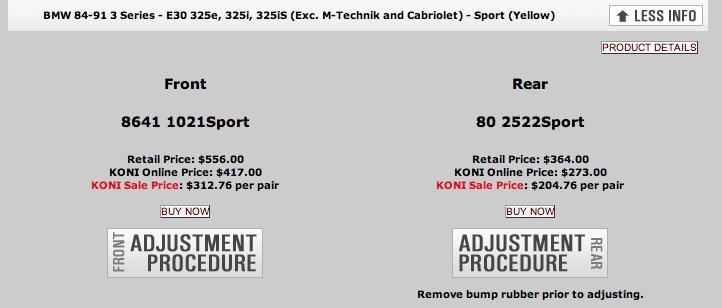

It's not necessarily cutting out the middle man from what I've gathered from researching.Ok Mucci. I'm wanting to go to coils and cut out the middle man (GC.) Which inserts do I need to order? With Koni's 25% off, this could be a good deal. I'm looking to go low and still have some damper to sit on. Suggestions? It doesn't look like the "Race" dampers are part of the deal; maybe i'm misreading it.

So this means Koni sports, made for the E30, are like $515 IIRC.-tim
