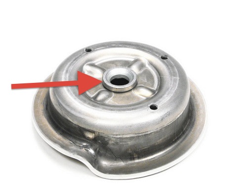

    So no pic's of the grinding issues against the strut tower? I'll be ordering the e90 hats and the washer that's suppose to be between the drop hat and bearing. Hopefully there wont be fitment issues. I'd also like to add that I too read all 18 pages.
    Also, is this the piece you hit off with your BFH
