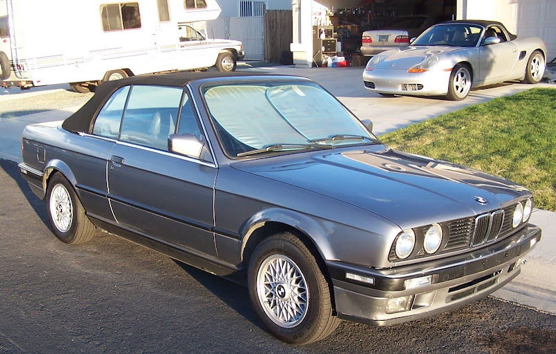

                          my experience with these drop hats
                          Originally posted by ForcedFirebird
                          That happened to me too when installing these on a customers' when the original guy was selling them. I had to add washers between the hat and bearing to clear them, almost making up the ~10mm drop :(
                          i have done these to a few of my vert's
                          had these on eibach pro kit with stock shock, no issues at all, it felt "nicer" too
                          i just installed these with H&R springs and koni shock, again no issues.
                          for those of you that might be into the type of ride i am - i installed the factory washer (roughly 2mm) under my new strut bearings to eliminate this grinding as the pics above show.
                          i also put in all new 3mm rubber spring pads/isolators. i am sure that my entire current setup will settle over the coming weeks and i'll post up a picture with the specs (i changed everything... so it will take a while to work in).
                          there is a difference in construction - the e30 hats are a thinner stamped steel where the e90 hats seem to be an extruded or stamped thicker aluminum.
                          to me, it is a no-brainer, $25 for a few more MM, realistically 5-10mm drop.
                          i can attest to it NOT being a job you want to do by itself, it's not worth the work, BUT if you are replacing springs or shocks, i would certainly add it to the parts list.
                          i have a full bagged minitruck, my intent for my e30's is to have a responsive every day driver that i don't have to pick my route based on approach angles - but looks and performance are priorities.
