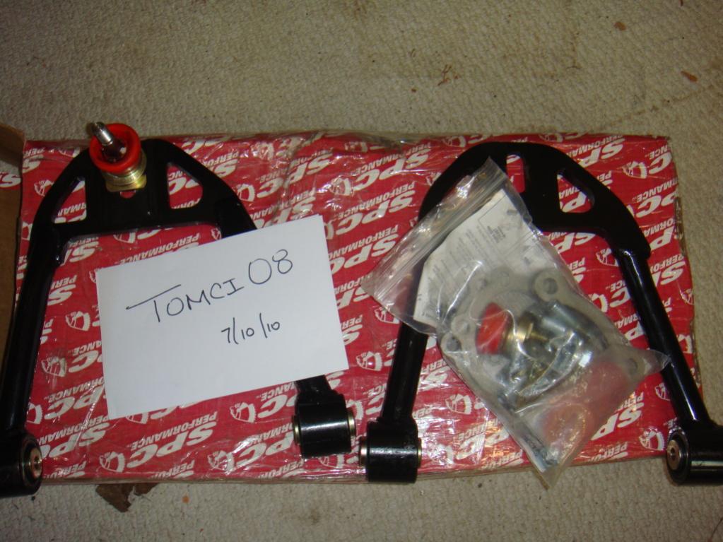

                      I just bought these from a guy on my350Z.com for 250.
                      I'll just get the rears for 179 and call it good.

                        LOL, SPC was one of the brands I was trying to steer you away from.

                          How come? it is the brand people on the Z boards recommended. Is the rear arm ok?

                            Yeah, it's no problem, but I didn't like the drop in the quality of their stuff over the past 10 years or so. They are the brand that all the shims, kit's, and alignment stuff comes from, for mostly stock cars. I was suggesting a more race bred part because of the benefits those parts usually have to be stronger than OE style. If the z board peeps say they are good, then by all means go with it.
