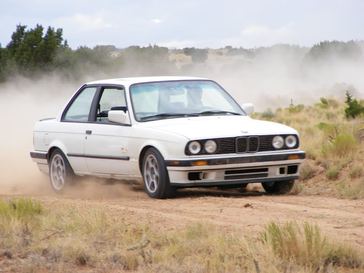

                          And to the OP:
                          I have Billy sport/H&R race setup, and an M42 (read: super low oil pan), and I have never cracked my oil pan once, and I have even done this:
                          So you should be just fine with your setup. I am very happy with mine, but in the future I will want coilovers...
