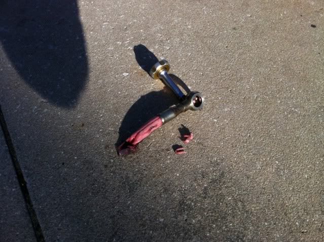

    On the last lap of my Sebring DE last weekend, my power steering died on me. I got to the pits and popped the hood. The belt was intact, the fluid level was pretty good - no obvious signs of problems.
    Fast forward to today and my Dad had a chance to start tearing into the system. This is what he found. It looks like something clogged up the line. What knowledge can you guys lend?

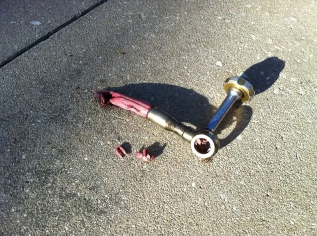

    The weird pink/white material protruding from the banjo fitting is the filter/screen that used to be in the fluid reservoir. It seems it came loose and the pump sucked it down through the line to the fitting, where it became jammed.
    I've never heard of this happening before, but it seems to have cost me a pump and a fluid reservoir.

            Would you believe this shit just happened to me again!?! My ps reservoir is now running filterless. what a weak ass design.
