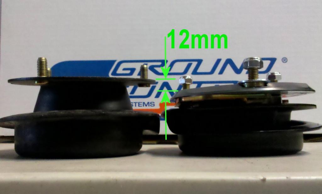

    IIRC the IE plates are poly. GC is spherical and has a shorter stack height.
    spherical > poly

        I dd on spec E30 GC plates, no problems and I love them, not to mention the lower stack height.
          spherical > poly
          Actually GC has both.
          The confusion is my fault for making too many e30 camber/caster plates. :loco:
          GC race= small bearing for clearance
          GC spec e30 race = big bearing
          GC street prepared race = small bearing for clearance
          GC rallye30 = big or small bearing
          GC Street /Touring = center urethane bushing with steering bearing
          GC 325ix = big bearing
          If you have stock diameter springs , the best choice for the OP is the touring plate.

                i have the IE now,and they are ok,seem to raise the front up more than i wanted,even with race springs...my M3 will have the GC

                  I have the GC plates. love them no problem, just remember to grease them so they dont 'pop'
                    spherical > poly
                    IE has three different plates.
                    Spherical encased in urethane = street/track
                    Spherical adjustable = adjustable race
                    Spherical = Spec E30
                    Hope that clears things up a little. Call/email if you have any questions
                    Andrew @ IE

                          Nothing negative to say about the IE race plates I have/had. They offer the shortest stack height from their lot. I'm fond of GC though and would choose them over the two if given the chance.
