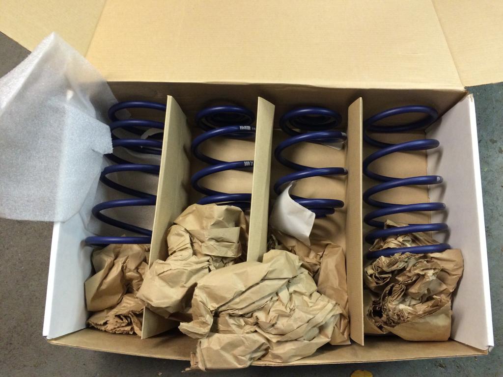

                          I have OE Sports installed on the ETA and Sports in transit. Looking forward to adding to the confusion :-)

                              The sports I recently installed (50406) were blue with white markings also.

                                I believe you, thanks for the lesson in physics though. What I meant by white marking (not white lettering) is the dab of white paint at top of the left spring in the first picture. I'm just relaying what I was told by H&R, that is all.
