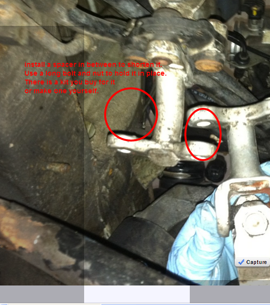

    OK guys, so last month i bought an m50 swapped e30. The rack was shot and I had a spare e36 rack.
    I removed the old one, read numerous threads on the swap, made my own spacers and hardware. I modified the nuckle etc etc.
    So yesterday I got time to install the e36 rack, i modified the lines so they dont hit the pan etc etc.
    I bolt the rack on and this is what i find.!
    The nuckle is way too long and there's no way it could fit the neck of the rack where it connects "not sure that you call it".
    So I decide to remove the spacers from the nuckle and it still wayyy too long..
    so now what???
    I'm not a mechanic but I'm pretty handy, I have a tracked prepared e36 M3 and I do all my work but this doesn't make any sense.
    Here are some pics so you guys can get a better idea.
    Help!!
    Suggestions, comments or anything would be appreciated, i HAVE NO IDEA WHAT I AM DOING WRONG!!!
    Thanks!

      all you have to do is put a spacer in between that 2 knuckle so it shortens.
        uhmmm, how can i put the space on top of it??

          Bernzpeed is correct. I think my spacers were 14 mm or so.
            ok I think i figured what im doing wrong,,, i was bolting them one below the other one, not interlocking them or however you call it:???:....

              I don't think you understand the orientation of the linkage.
              Maybe this pic of where to put the spacers will help you out:
              And ideally you should space up the actual rack on its mounting points as well.

                  Here's a better pic:
                    And ideally you should space up the actual rack on its mounting points as well:
                    you are correct, I was confused how to mount the linkage but I now get it after looking at some pictures and clarification...oh well, you live and you learn.
                    I am aware of the spacers on top of the rack...
                    thank you!
                      Neither do you , Teaguer. Bernzpeed is still correct, the spacers go between the two halves but after they have passed each other.
                        I do know where they go. Thats why i included the 2nd pic that shows the linkage assembled.
                        I also removed that pic of the rack spacer from my post because I noticed it says put the spacer above the rack which is incorrect.
                          Thats actually the pic that got me confused in the first place and thast why I mounted them incorrectly, but I now get it.!
                            thank you!
                            Dude, the rack spacers go BELOW the rack. Sorry for any confusion. Thats what i get for using pics from e30tech. :(
                              Fucking e30tech FTL!!!!
                              I got those pics from the link posted above. Fucking noobs over there!
                              Lol, Thank you, I wish I would of seen that picture before...:up:
