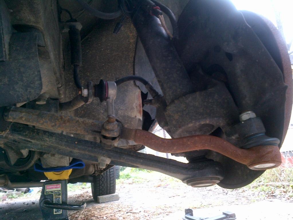

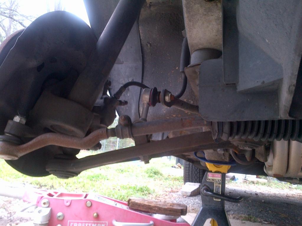

                          • jeffnhiscars
                            • Jun 2011
                            • 6010
                            I've read it over and over..."put the spacers under the rack" so the CA and tie rods are parallel. Perhaps my M10 sump is different but there was no room to raise the rack and get the spacers underneath so these pics are "spacers on top"
                            Sure look parallel with the spacer OVER the rack and my previous bump steer is 100% gone. Keep in mind that I have Eibach Prokits so maybe this configuration offset that change.
                            Spacers on top is does not appear to be always best. Dunno...just sayin'
