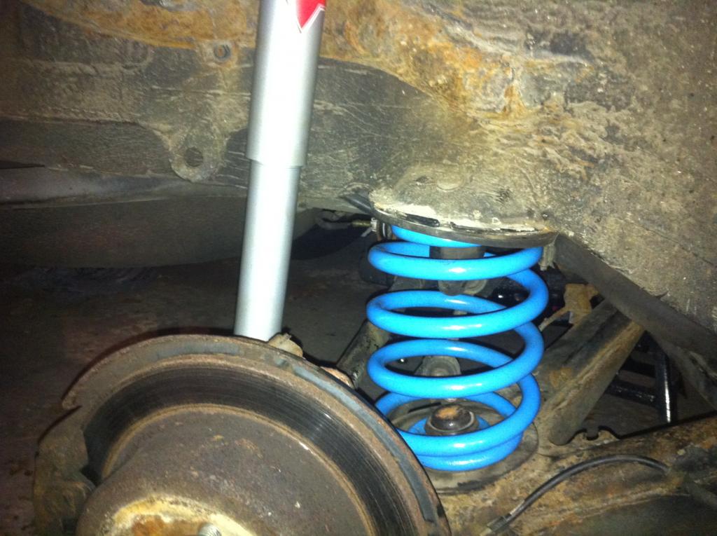

        • peytonracer4
          • May 2011
          • 524
          i got mine powder coated light blue.
          i havent driven on them but i've had them compressed and there's been no signs of damage on the paint.
