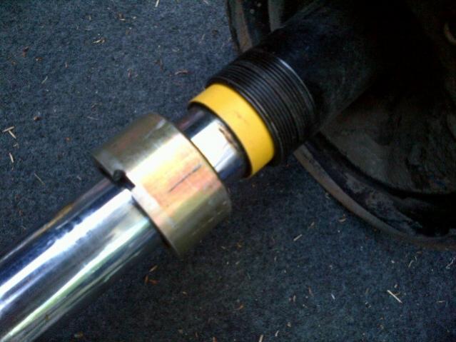

                Im trying to decipher what you have (with some difficulty I admit) but I can tell you this...the 45mm strut is threaded on the outside so the gland nuts will be threaded internally (see attached pic just taken of MY 45mm strut & BS Sport). Since you seem to say you have a 51mm strut & that it "appears to fit" then you obviously cannot have a 45mm housing (hence my confusion over all the 45mm references on the OP).
                On the other hand if you do have a 45mm strut (which of course would "fit" in the larger 51 mm housing), you can still use it but would require a special gland nut from Bilstein "Part number B4-B30-U232A1 $24.15 per gland nut".
                If you bought them new then they should come with the proper bits & pieces and you shouldnt have to deal with any of this.

                      Im not saying anything about a 51mm strut or housing since Im not looking at either. I am SHOWING you what a 45mm Strut and BS Sport looks like with the gland nut.
                      I have 3 e30's sitting in my driveway including the one I showed you the pic of (45mm) and I have personally NEVER seen a 51mm strut that was not configured the exact same way as the pic I posted but that doesnt mean it cant exist.
                      You have the parts in front of you. Why dont you MEASURE the OD of your strut housing and TELL US the part # of your BS Sport. Even better, post a pic of the parts that dont make sense to you and you will probably have this resolved asap.

                              The part # you have is for the 51mm strut housing and should actually be 36-00335 (not 34 since its a 36mm cartridge). P30-00334 is the 30mm cartridge for the 45mm housing which is what I have in my 318i. Regardless of what Bilstein lists for your car you have confirmed that you have 51mm housing and need 36-0335 and the nut that goes with it.
                              Its possible that someone swapped out what may have been stock 45mm housings in your car for 51's. Thats not really that important right now. What is important is that you have the wrong strut for your housings. As I said in my earlier post you CAN install a cartridge intended for a 45mm housing in a 51mm housing IF you use the replacement gland nut part in my previous post. Personally, I dont see why you should have to buy them if you bought NIB struts from a reputable dealer.
                              The difference in valving between the 2 cartridges in nominal and should not effect your handling, but since you bought them new, again as I stated before, you should not have to deal with this. You have 2 options at this point...either call who you bought them from and tell them its the wrong part and to swap you out..or..buy the gland nut I referred to and install the 30mm diameter cartridge in your 51mm housing.
