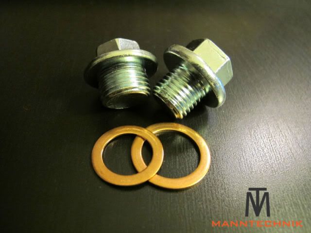

                    This is my nice and simple solution...
                    Cheap, clean and easy install

                          No need to have a loop of line or any atmospheric vent. Air is compressible, unlike the hydraulic fluid so as long as you drain most of it out, there are no issues with just plugging the rack. Plus it really cleans up the engine bay nicely.
                          Quick transitions are no problem and no binding of the rack occurs...
