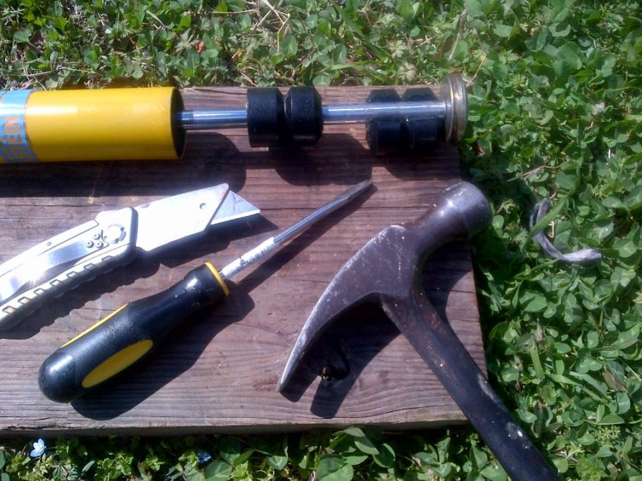

        You might want to look at shortening the front bump stops. I was riding on mine with the ie3/Billie sports setup.
        There are a few tutorial threads on here for doing that DIY.

          Ditto. I suffered thru years of bone shaking from the bump stops. If the struts are out its 5 min/side. The end cap is a light press fit in to the tube (which I held with my foot) and taps out easily with a screwdriver.

            Another vote for shortening the bump stops! My car rides great now!
