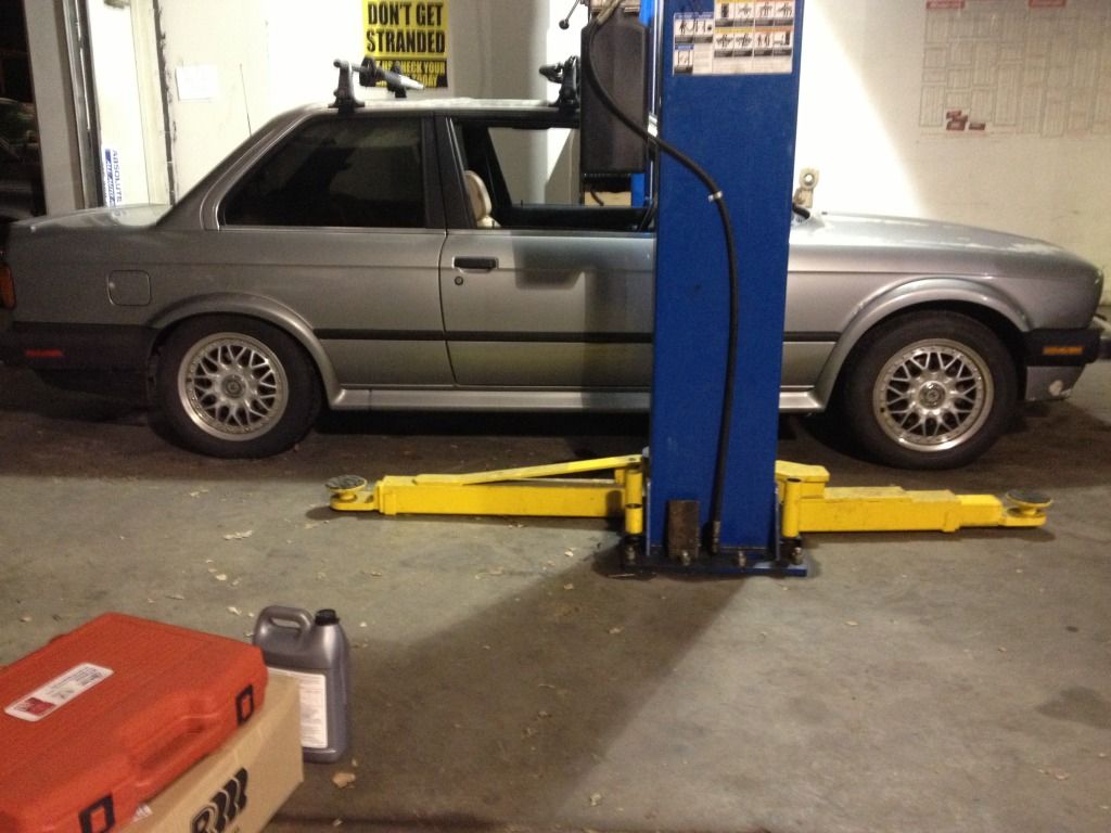

          im not trying to slam it but when the front sits up higer thant the rear it just looks stupid. Look and the huge fender gap in the front. It looks like i just lowered the front. see how nice my 7 sits. I dont want it this low but you get the idea. i guess im just gona have to get some coilovers bc this just is not doing it for me. i might try the e90 hat or find some drop hats first.

            Give the springs a couple of weeks to settle, if you're still not happy with the drop., remove the front spring pads as mentioned earlier, if that doesn't do it, go ahead and get the different drop hats. Once you've done all that and you still are not happy, cut the dead coil and stance your IX.

                Taking the pads out and putting on some e90 drop hats will give you close to an inch of drop
                It should look fine after that
                      It looks to me like the body of the car is sitting pretty darned level, if a bit down in the front. The fender gap is a different issue. The front fenders are a higher than the rear so the same drop all around will result in a greater front gap.

                        Honestly, it definitely looks like the front is sitting slightly higher, but hey; we might need more pictures for that
                        Anyway, just back to let you know that GC camber plates will reduce stack height by another 12mm; coupled with removing spring pads (~8mm) and the drop hats (15mm) you'd be getting almost 35mm of drop with increase travel (because of the camber plates [Thats good])
                        That's abut 1 3/8" of drop
                        Mix and match what you think is needed
