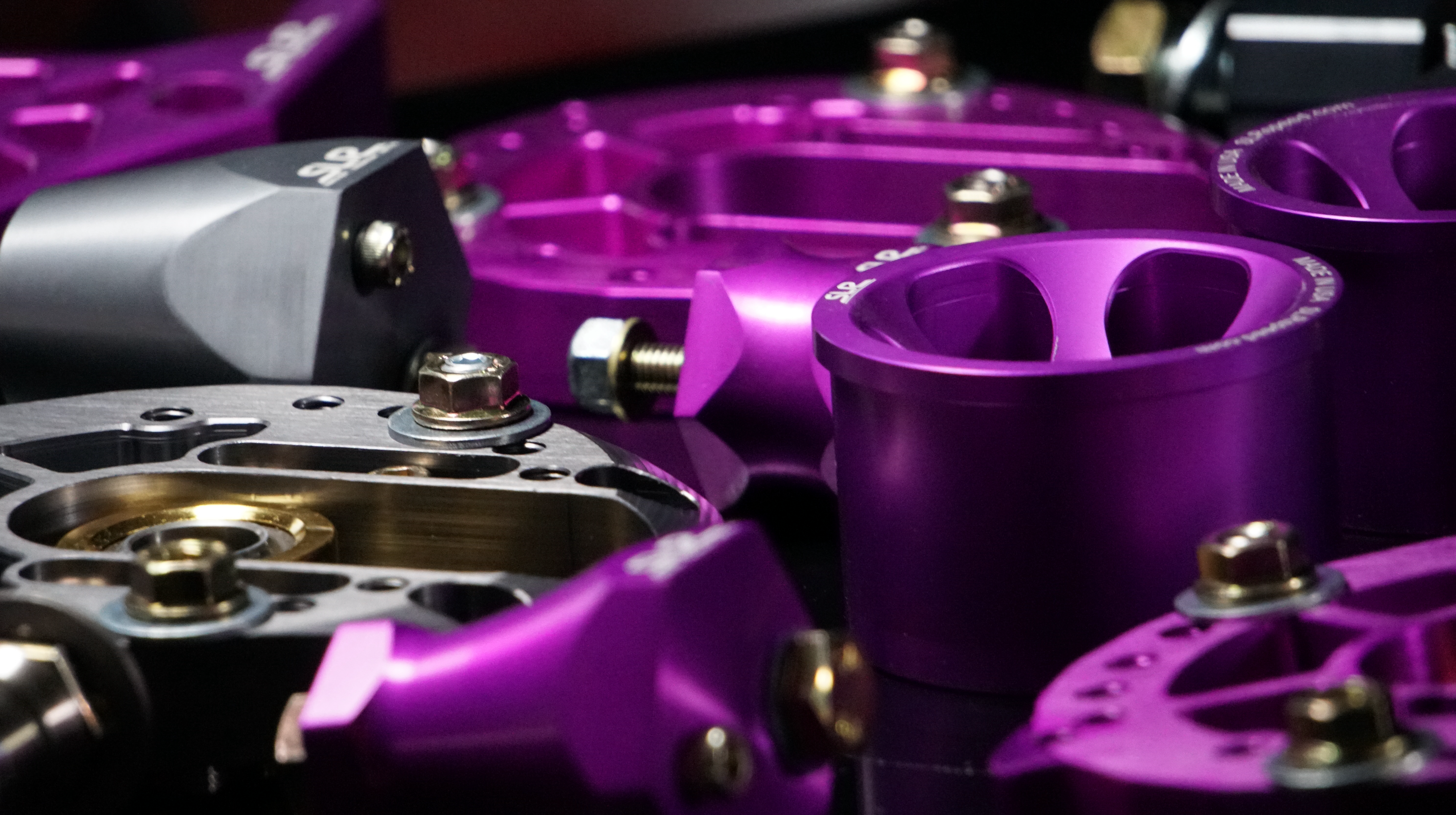

              If you dont want to bother messing with stuff,
              Trusted by top racing and drifting teams worldwide. Angle kits, Coilovers, Sway Bars, Camber Plates, Caster, Lock Kits, Drifting Kits, Toe Plates, Wheel Hubs, Steering Kits, Drifting Suspension, Subframe Brace, Control Arms, Lollipops, Coilover Conversion, Lower Control Arms, Steering Rack Stops, Lock Limiters, Tie Rod
              Denofa uses it (or used it? idk if its on his new car, id assume so)
              Im going to get one myself when i get the extra cash, also from what ive heard the guy that makes it Sean, is a pleasure to deal with.

                whats the price on such a kit?
                • FLG
                  • Sep 2011
                  • 3165
                  Last I remember around 900ish

                    I was looking at this kit, but it is just out of my price range, plus im not skilled enough to utilize the kit to its full potential yet. I have heard great things about it though.
