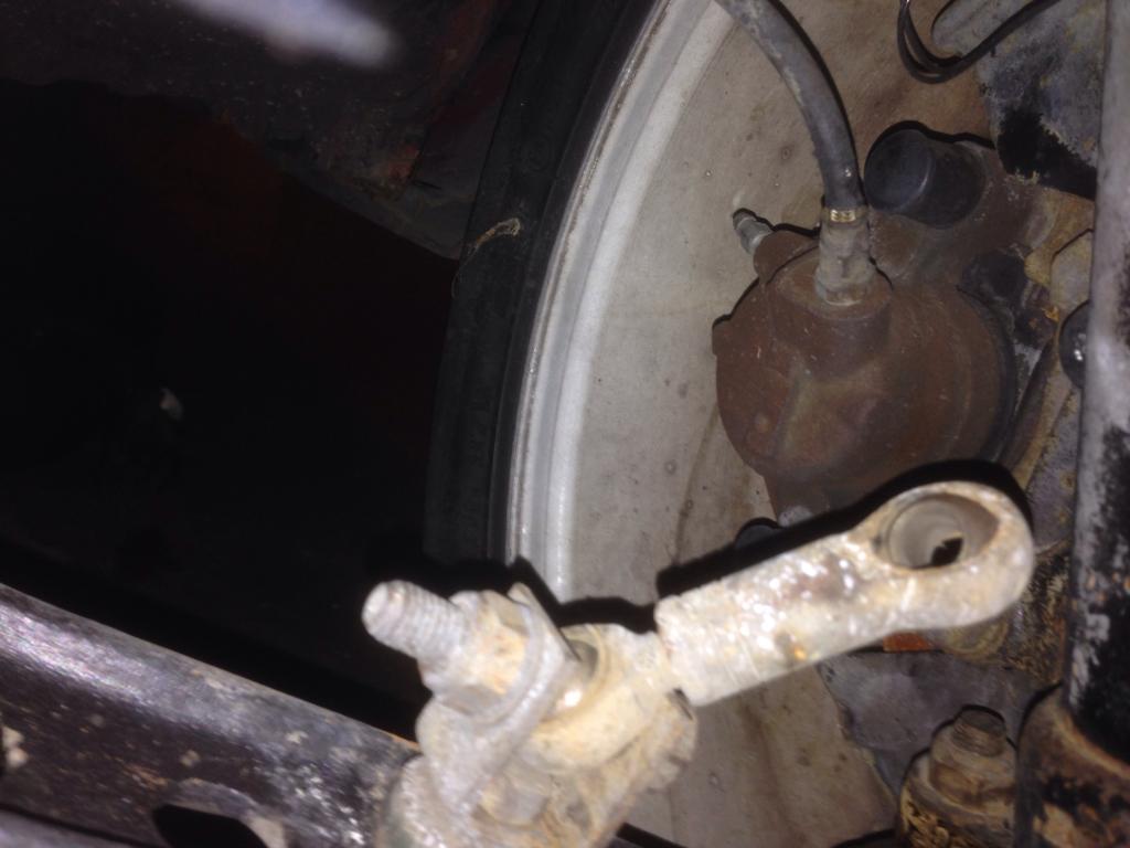

What type of sway bar links are these?
  • amcink
    • 788
    I need to know where I can get these?
  • pantelones
    • May 2011
    • 533
    I.E. adjustable, or AKG now sell adjustable links... Word of warning, keep them oiled frequently. They will go to shit before you know it if you don't.

      Meaning...just spray them with some WD-40 every now and then or...? I was looking at getting a set of these but I was wondering about maintenance.
      • acolella76
        • 2950
        Just buy your own rod ends from McMaster. That's what AKG and IE do anyway.

            IE stuff is cheap and dosnt last long.
            If you want to spend some cash go to VAC and get power gride ones. Last you will ever buy. They were made for the American Iron series.
            OR
            Go to 949 and buy his. I have them right now and I like them.
            http://949racing.com/SuperMiata-miata-end-links.aspx
            OR
            I have not tried this but I think the ground control ones will work in the front.

                        Make sure the links aren't binding. Many people install incorrectly in a way that binding premature failure. It will take some tinkering to get them oriented so they don't bind and the best way is to move the control arm through the full range of motion with the car on stands to inspect rotate the lower mount as required to alleviate binding. If you install them correctly, they will lost a long time.
                        • bmwguy325is
                          • May 2011
                          • 1263
                          All good notes as mentioned above.
                          The first pic seems like the wrong way to mount the link as well.
                          The oe mounts are offset 90 degrees from each other.
