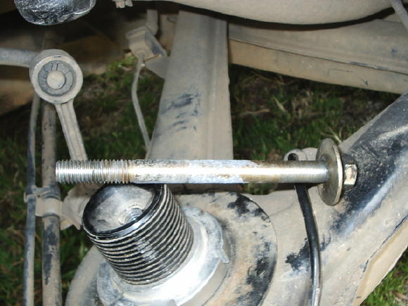

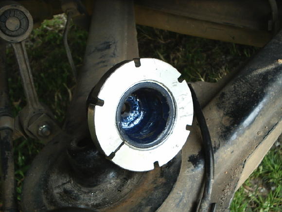

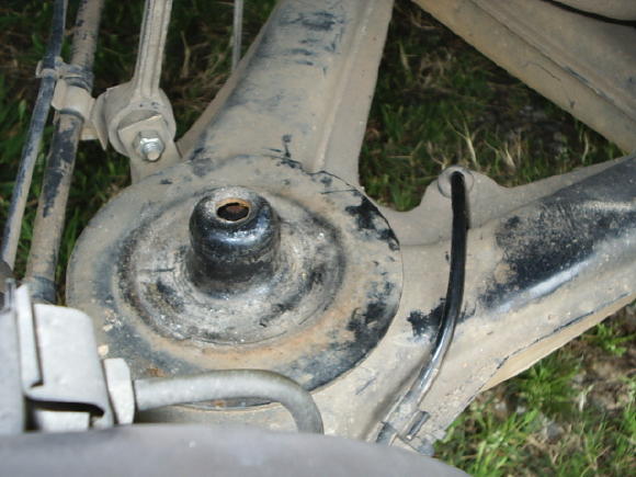

    I seem to get atleast one pm a week with people asking me how I put the e36 obx coilovers on in the rear. So, it is easier for me to just make a thread to refer them to.
    Drill a hole through the rear trailing arm to mount the sleeve. I used a long bit and a right angle chuck, and did it from the top. Use a punch to start the hole, use a smaller bit to go through the first time. Then open it up with a larger one.
    The threaded sleeve needs to be drilled out to fit over the nipple thing all the way. You could not do this, but you would have about an inch less adjustment. I used a drill press and a big bit. Then I finished it with a carbide bit and rotary tool.
    Two years with no problems, dun hate

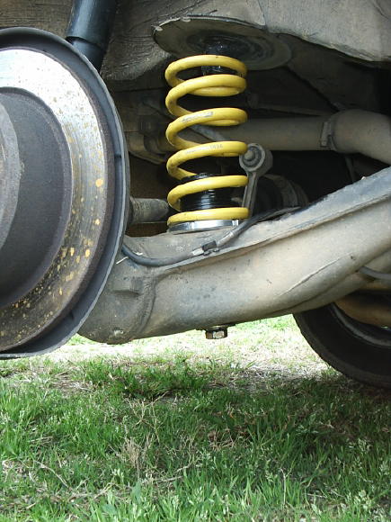

    Here is the original picture of the spring. The resizing made it look weird.

      So what keeps the spring centered on top?
        The kit comes with a urethane pad, I had it out in the pic to remove the stock one. I had them stacked but now I am just running the urethane one.

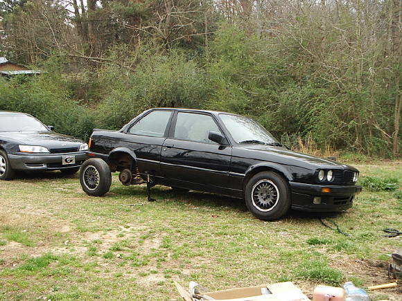

                      whats with everyone jacking up their car with the stock jack on gravel or grass or not on pavement or concrete?
                      • arsevader
                        • May 2005
                        • 1025
                        I guess it's the thrill of it all.
                        I barely trust the stock jack to change a wheel, let alone do any serious work.

                            Stock jack on grass.
                            That looks like Georgia red clay. Harder than concrete when dry. Isn't that jack a product of "superior German engineering"? Before you hit the reply button, I am being facetious!
