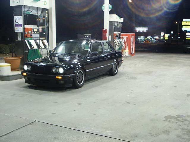

      In the front the OBX install is pretty easy. You can install them unmodified, but you will lose a little of the adjustment because the adjuster will eventually hit the stock spring perch. I just cut off the stock spring perch, but I left about 4mm up from the welds for the sleeve to sit on. I used a cutting disc and finished it with a dremel. With the stock perch removed this is how low it can go. Extremo dump
