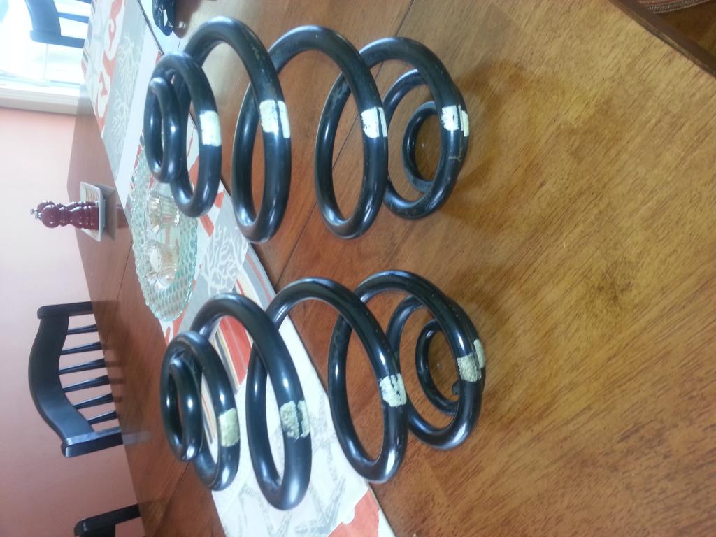

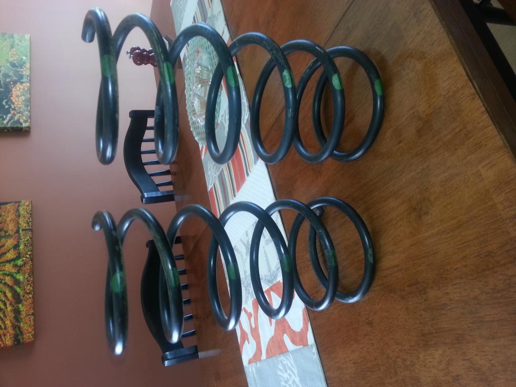

    Ok Suspension gurus, I've got a few questions for you...
    First off, I bought a set of springs from a guy who sold them to me as M-Technic springs. When he bought them, he thought that they were M3 springs but now believes that they were actually M-Technic. Is there a difference? Here are the numbers:
    Front-1130046 Rear-2226147
    I was able to find this info somewhere online. However, without a reference I'm not sure I can trust it.

    E30 M3 front spring BMW part # 1130046
    D = 5.09"
    d = 0.484"
    Free length = 12.69"
    Total turns = 6
    Spring rate 132 lbs/in
    E30 M3 rear spring BMW part # 2226147
    D = 5.04" (in center)
    d = 0.590 (in centr)
    Free length 8.38"
    Total turns = 6 1/4
    Of course, I have pictures attached.

    Yes those are e30 m3 springs (green paint markings). If you go through the vert suspension thread there a few folks running them. You should sell me them lol I needs some fronts for my vert.

              It's my understanding that M3 and M technic are the same springs. The easiest way to combat the reverse rake on verts in particular is to stack pads or washers in the rear to raise it up a bit. Even stock verts are relatively low in the rear with the extra weight and lower rear arch.

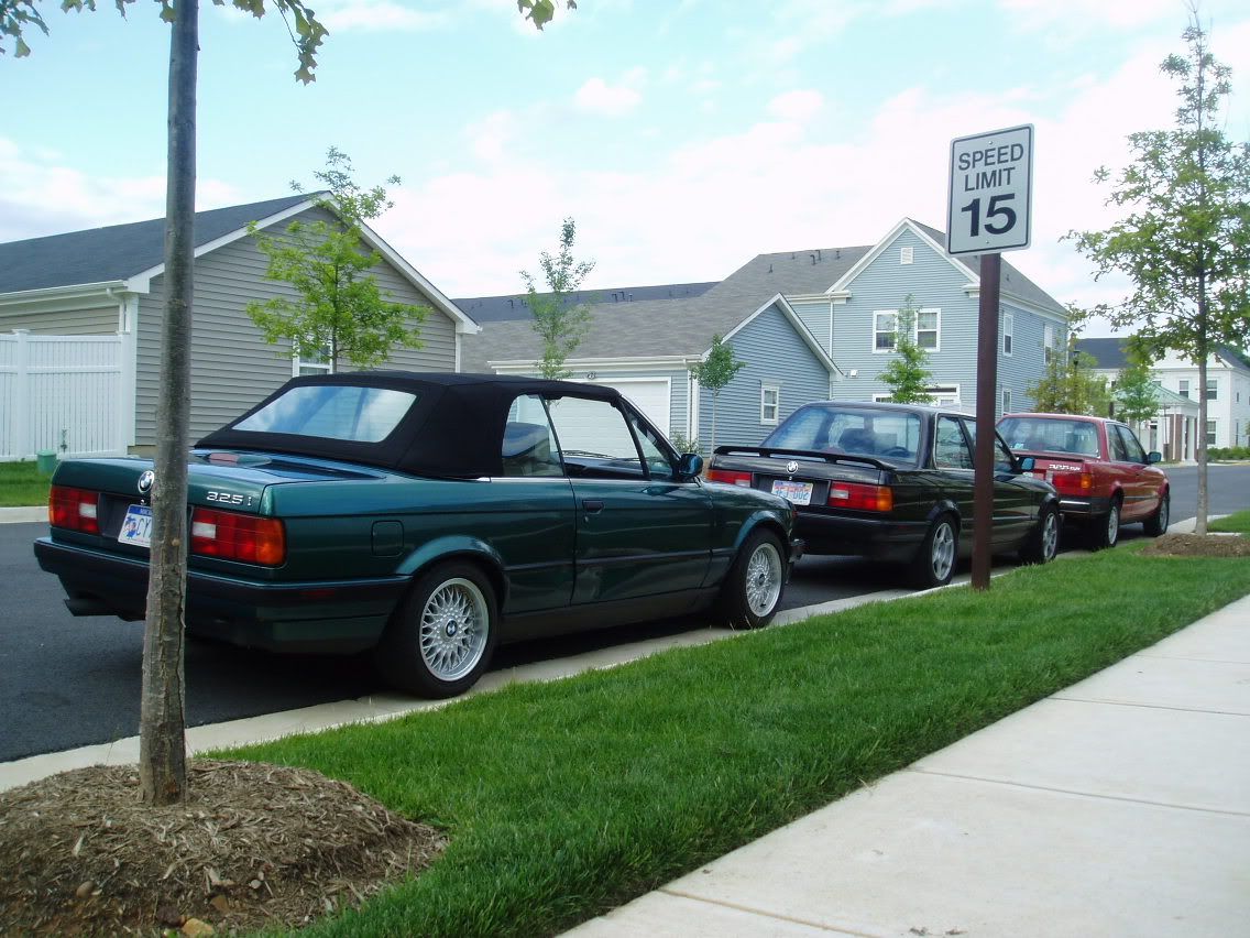

              • M-technik-3
                • 18946
                here is my old vert on them, granted the tires are 205-50-15 vs 205-55-15 but you get the picture.

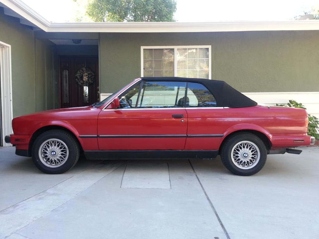

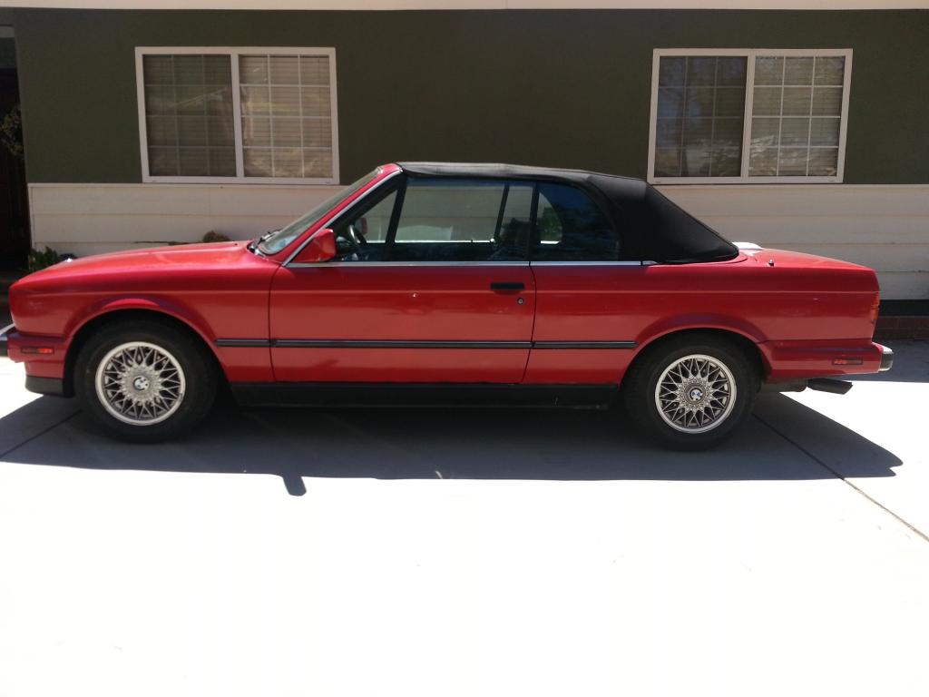

                        I finally got around to putting the M3 springs in my vert. I've spent the last couple of weeks doing the head gasket on my daughters Volvo (pain in the ass!) Here are the before and after pics. For reference, I'm running factory 14" weaves with 195/65r14 Falkin Ziex ze329s on Bilstein HDs.
                        Before:
                        • cavpilot
                          • Dec 2013
                          • 112
                          After:

                            it will settle down.
                              It's hard to tell from the pictures, but the drop is noticeable and pretty much where I wanted the ride height to be. The biggest difference is in the ride comfort. These springs are definitely softer than the stock cabrio springs. That;s ok though since the stock springs with the HDs were a little too harsh for my liking.
