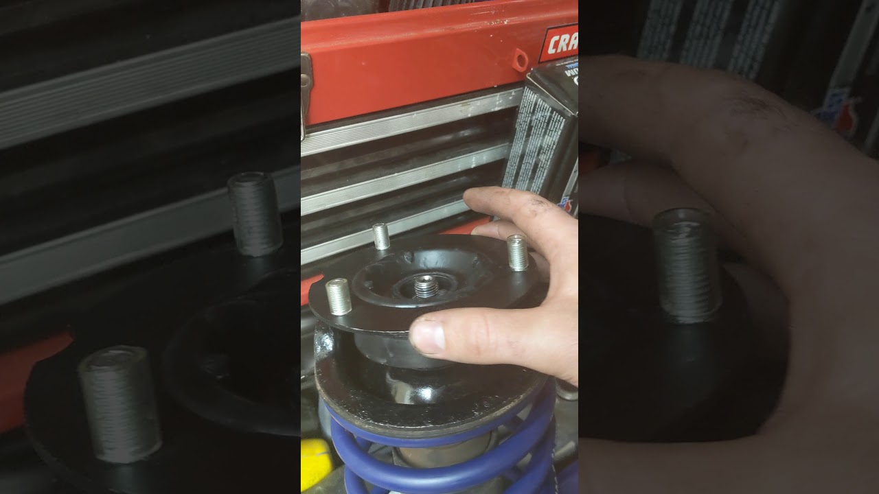

    This is an older thread but I am very happy I checked the fit of my Koni Orange STR.T inserts to my Sachs strut top mounts prior to taking the car apart.
    Like the OP, the my Koni Orange (non adjustable) inserts use a 22mm top nut. A 22mm impact socket will not clear these Sachs brand strut mounts in which the opening is approx 31.5mm / 1.235"

    Just to follow up, I used Sachs upper mounts PN 31331139452. They fit a 22mm socket just fine.

    I measured way back in the day, not even a thin wall socket is going to fit in this situation. The opening is just too small no mater what you do to tighten that 22mm top nut using the stock top mounts.

    Like I said, both brands "Boge" and "Meyle" top hats will work just fine. Glad my thread finally helped someone, totally forgot about it. Back when I was just a rookie :D.

    i recently used meyle and ya it has the big hole.
    also my konis use a 19mm nut. maybe just go to the hardware store and get a 19mm nut instead of that 22.
