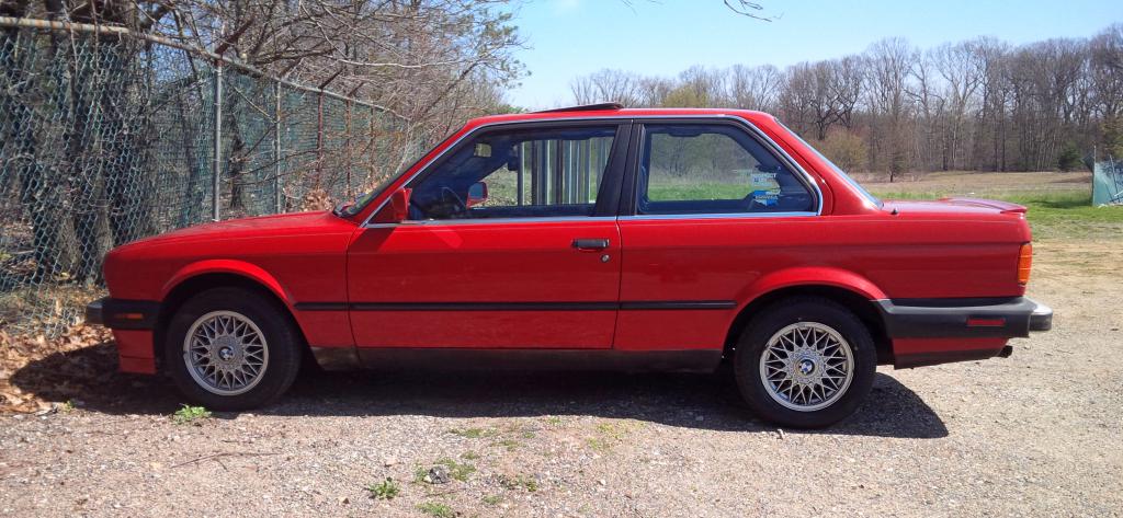

    lowering help
    Hello Fellas... I need some advice on lowering my BMW 1988 IS. Don't get me wrong I been looking in the forum. but I'm getting confused don't know much
    about lowering and what's involved .. I would like to know if I can go with the original shocks and buy lowering springs or I have to go with a full kit, I don't wanna slamit but just to give a nice stance Im on original basketweaves,.. any thoughts.. thanks dester607

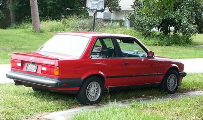

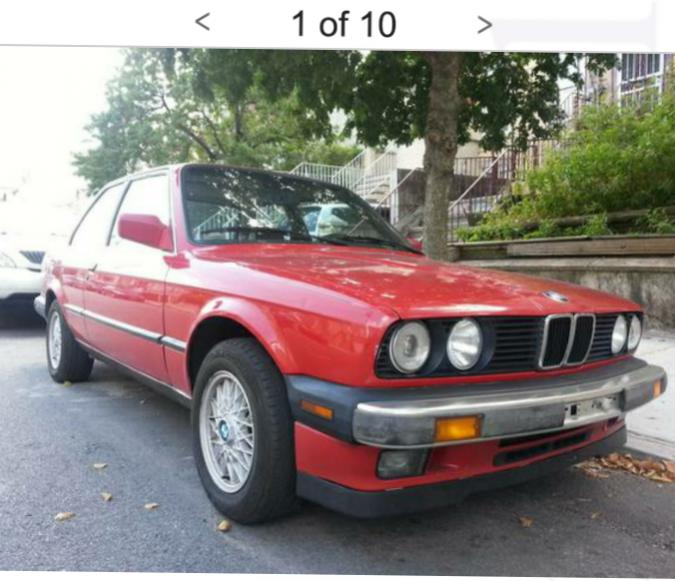

          Ski...I would like to lower my E and do understand the sacrifice in ride difference but I don't wanna it to be huge just asking what is the softer shocks and springs to go with...adjustable damping is complicated for me to much involved. this would be my first lowered car my pic is saying help me lol
