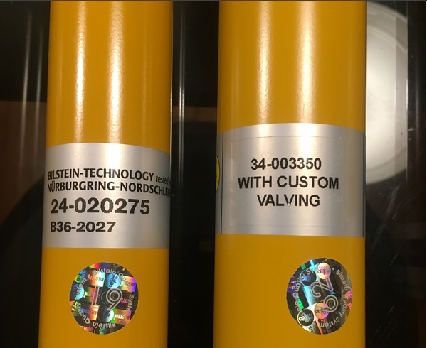

    One reoccurring point that many people made is that it is best to get your shocks revalved to match whichever springs you choose. Upon opening the package from ECS, I noticed the box for the front shocks was stamped "CUSTOM VALVED" in red text. I also found the same words printed on the label attached to shock tube (see attached image).
    So my question is: Does ECS order custom valved shocks to match the springs for their "Assembled by ECS" kits?

    This is very cool if true and it's about time. Hard to dispute when there's a Bilstein label that states " Custom Valving" right on the dampers. I'd email ECS to confirm.

      Interesting, I know Bilstein is trying to improve customer-service state-side (years ago it was horrendous). However, those part numbers are standard E30-specific numbers, meaning they are available from any Bilstein reseller.
      Unless it says "ECS" specifically on the same tag then I'm guessing it's not an exclusive.

        Sent an email to ECS Customer Service last night. Still awaiting a response. I agree though, it would be really interesting if they do provide custom valved shocks for all their ECS kits.
        I do find it weird that only the front ones are labeled as custom. If this entire thing is intentional, I would want to know the reason.

          UPDATE: Sorry it took so long for my update. The email from customer service was actually sitting in my spam box for several days before I noticed it.
          Here's what the email from Dan Miller @ ECS Customer Service said:
          __________________________________________________ ________________________
          Hello,
          Thank you for contacting ECS Tuning. Yes, the kit is custom valved for the springs. We try and ensure the most dialed in experience when it comes to those race kits. Thank you for shopping at ECS Tuning!
          I just finished installing the kit yesterday. With my setup, its definitely stiffer than stock, but actually very bearable, considering the extremely terrible roads in my area of Jersey. Bumps definitely do translate into the cabin, but I feel like it wouldn't be as pronounced if I didn't have all poly bushings (80a everything). It doesn't seem as rough of a ride as what many people on the forums previously described it as being (Probably due to the custom valving!). You do feel the bumps in the road, but more through the steering wheel than the seats (again, probably Poly's fault!)
