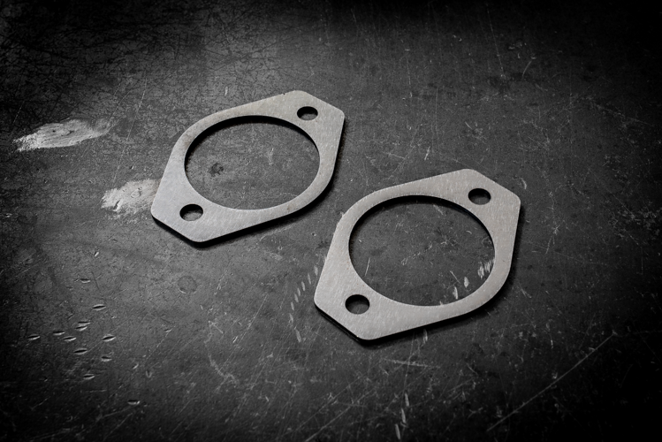

        Welcome, you will also want a reinforcement:
        BMW REAR SHOCK REINFORCEMENT KIT Overview BMW sheet metal at the top of the rear shock towers in E30, E36, and E46 BMW cars is a well-known weak point. The metal tends to tear over time, especially if stiffer shocks are used. This is really cheap insurance to not need to repair shock mounts in the future which is known

          Thanks parkerbink. I'm using Rogue Engineering RSM's, should be integrated. Can't wait to get this thing on the road again!!

            the plates go on top so are not part of the rsm. $20 well spent
