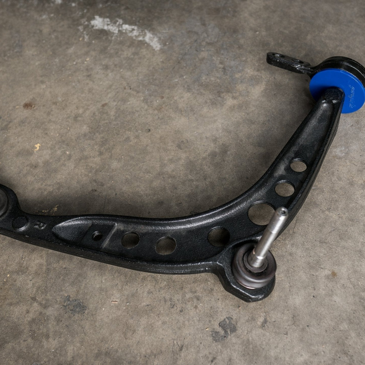

    After the brakes, the next thing I did when I bought my e30 was to refresh all the suspension in my car and the difference was amazing! However, especially if you are paying a shop to do the work, you don't want to just throw parts and money at an issue. But you can look at the CABs pretty easily and see what kind of shape they are in. Possible the left one is totally shot.

                My wife's e30 had the original front struts when we bought it, they were completely gone and it drove fine. I agree that a clunk is most likely more than just a bad strut.
                I assumed the shop would have checked the tie rods and the control arm ball joint, but based on your description I wouldn't bet on it. Like FF said, check the ball joints too. There is a pic in the link I posted that shows how to do that.
