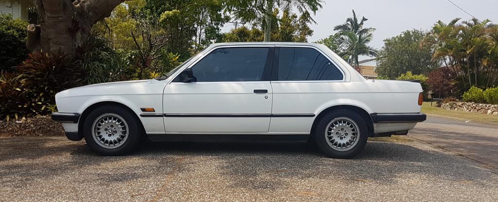

          But anyway, for reference essentially i am very happy with the setup at the moment. quite compliant for street use but stiff enough to not bottom out. and when you get into it it really grips very nicely and generally handles very flat. Anyway, no more ranting, here is a photo. it looks way better now too:)
