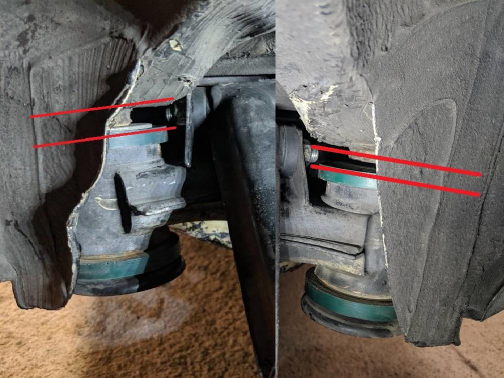

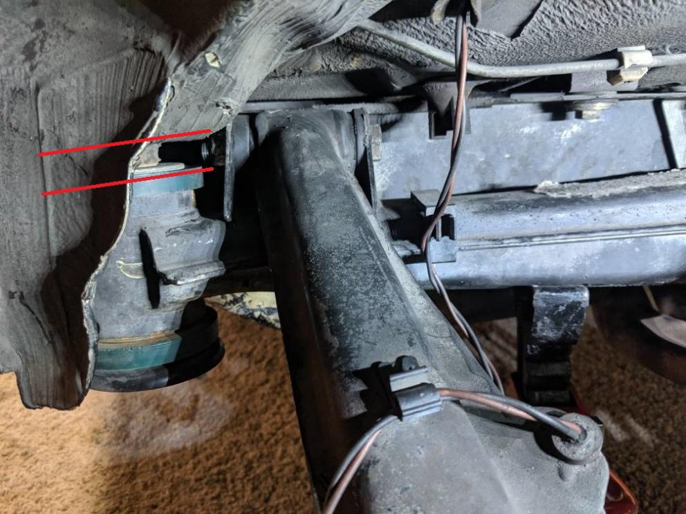

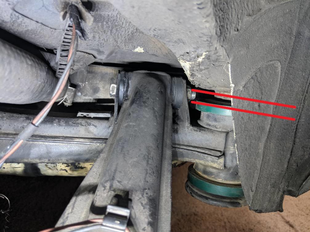

                  • 2mAn
                    Señior Mod
                    • 20988
                    Are these pics with that extra spacer back in?... because I see a spacer on the driver side
                    The gap between the subframe and the body looks different on the two sides.

                    • E30Bastard
                      Shimmy Shimmy Ya
                      • Nov 2018
                      • 245
                      Ya, that's the spacer. Was just trying to show the unmodified upper perch in that pic.
