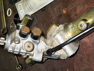

          i wrote instructions on modifying a power rack to make it full manual. it should be on this site. i also made a spaner wrench which i can send to anyone if they need to borrow it.
          • xLibelle
            • Aug 2004
            • 2673
            remove this seal.
            plug the lines.

              good deal I will be Tempted to convert it true manual.
