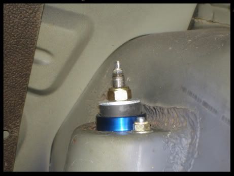

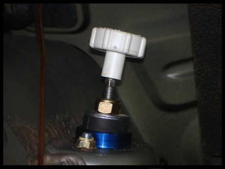

                  Thenew Konis adjust the same way that the fronts do.
                  And are awesome, so easy to adjust takes about 10 seconds. Id recommend them to any one.

                        The Koni SA's from GC are top adjustable. To be able to adjust the rears, you need to cut a small hole in the trunk lining so you can get the adjuster in to the top of the damper. Very neat.
