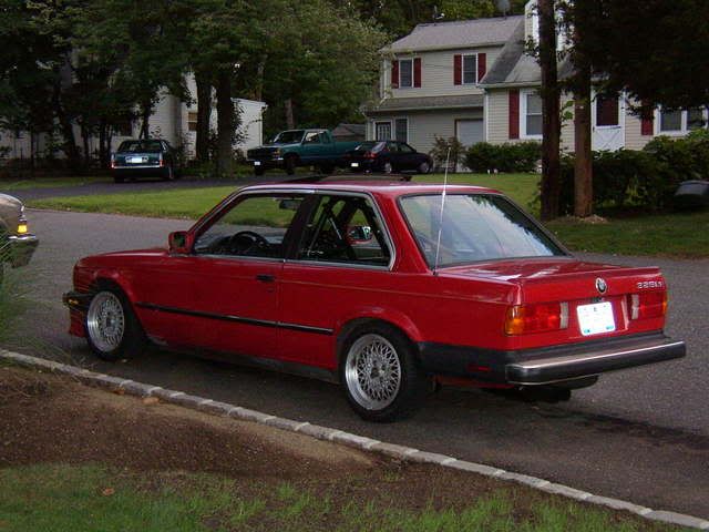

                    haha. your post didn't seem too impartial. informative, yes. But i don't think "crappy" is an objective term.. i'm partially kidding man. i do appreciate your educated response, even if it wasn't really aimed at me. seems as tho you have an overall beef with people who lower their car beyond that theoretical perfect ride-height threshold. trust me, i'm not arguing that age-old slammed vs. parallel control arm argument. i've been doing this too long man. i was just new to e30's..
                    btw, i thought i mentioned that i do have the shortened s/a's, and the rears are top adjust.
                    so far so good with the cosmos. a little soft i find tho, but that's subjective.
                    i spoke to GC, and they offer a 5.5" rear spring( that isn't on their website unless you search 5.5") at a decent rate that i might get into..
                    my car is not bouncy at all BTW. this aint no cut spring/stock shock setup..
                    cheers..
                    -errol-
                    oh and here's a kinda recent pic. the rear bumper has since been tucked, and the wheels have been refinished..
