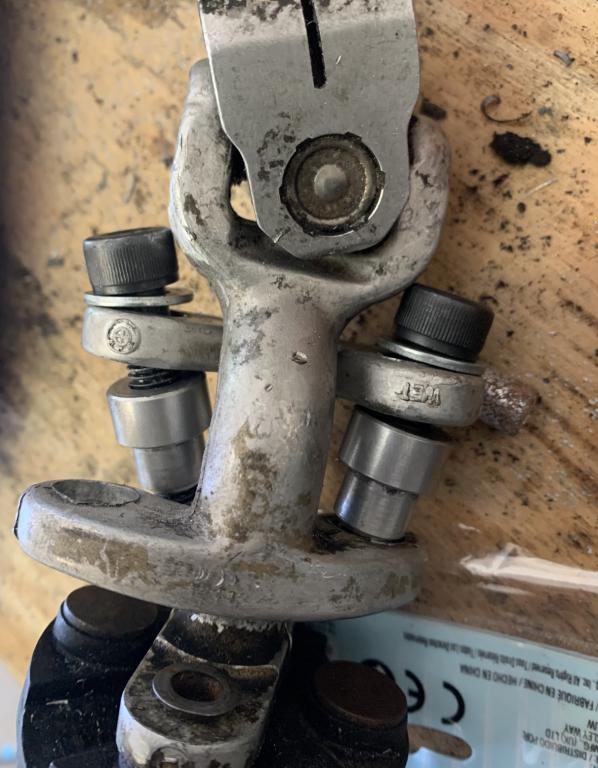

    I ordered the non-airbag spacer kit with new hardware to modify the steering joint and I must say (unless I’m an idiot) I’m not happy with how this “kit” fits.
    Do I need to remove a significant amount of metal off of the joint to get the bolts to go in? I’ve tried lots of different ways and I can get one end in but the joint has to be titled, therefore making it hit the other bolts head. Am I being an idiot and not doing this right?

    I used their kit to install an e46 ZHP rack, it's been a little while since install. I do think I remember needing to drill out the holes in the steering coupler a bit in order to allow the spacers to sit down into the hole up to the level of the shoulder on the spacer. It's a tight fight but it will work, and is nice and solid once you get everything tightened down. Another thing you'll need to do is use a file or a small grinding wheel on a dremmel to shave down the upper coupler joint otherwise with the more acute angle that the steering knuckles will need to attach to the new rack, the top joint will want to bind.
    Drill the holes out a bit, when the spacers are able to sit down all the way up to the shoulder in the spacer you will have enough room to wiggle the bolts in:
    On the op knuckle (end that attaches near the firewall), file/grind down the area highlighted by the arrows to give the joint more play and avoid binding:
    Also a word of advice, not sure how you're going about replacing the rack. When I did mine I dropped the subframe (was replacing other things at the same time) and attached the rack to the subframe and lifted it all back in together. I got the top knuckle secured and bolted up first, make sure you get the bottom seated on the steering rack splines first before lifting the subframe/rack assembly into place. I lifted the subframe up and bolted it in place and learned the hard way that there isn't enough play in the knuckle to get it seated on the rack once the subframe is bolted in. Had to drop the subframe again and seat the steering knuckle first, then lift the subframe/rack assembly up again. D'oh.

      Well shit - there could be my problem. I’m trying to put the bolts the other way.

          I looked back at the video and he starts out putting the bolts in one way but at the end it’s exactly how you have it.
