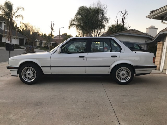

                  Decision made, wheels/tires on car!
                  Ronal LS 15" & YOKOHAMA ADVAN FLEVA V701
