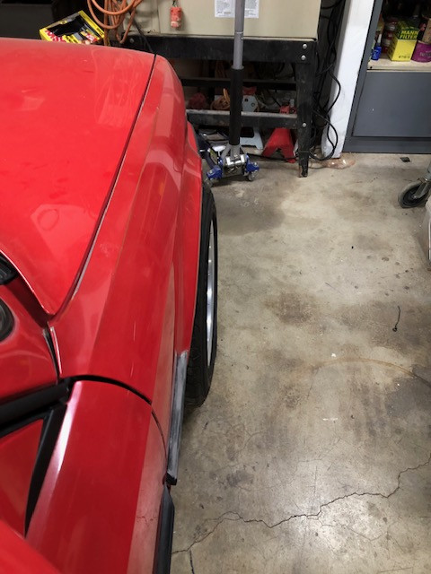

  • OSAH racing
    • Apr 2022
    • 244
    with 15 mm spacer
