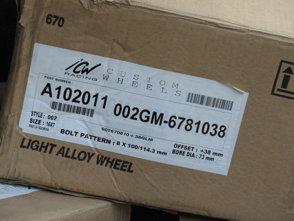

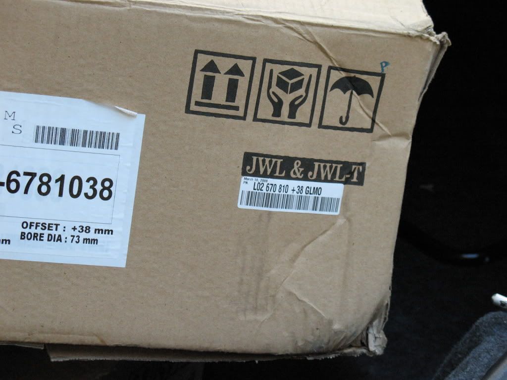

    16", Those appear to be the original boxes, so I take it they are ICW wheels. I tried googling all those various numbers and nothing came up looking like this wheel. In the ad, she said they are Enkei, but she may have been wrong. Said they came off her '89 325i.

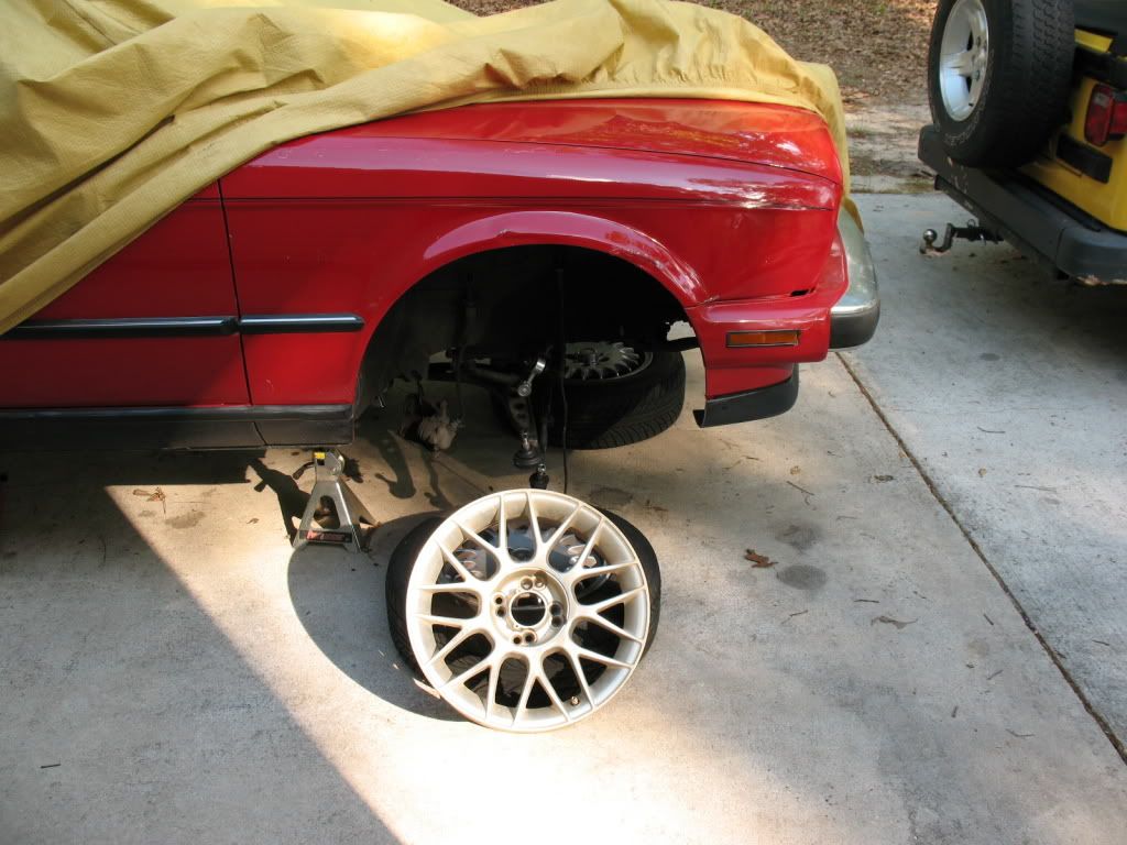

    They are 16" rim, the box says 7" width. From what I read that means I'll use a 225/45/16 size tire? The car is getting H&R sport springs, will I run into any rubbing or clearance issues with this setup?
    PICS!
    Room to spare!

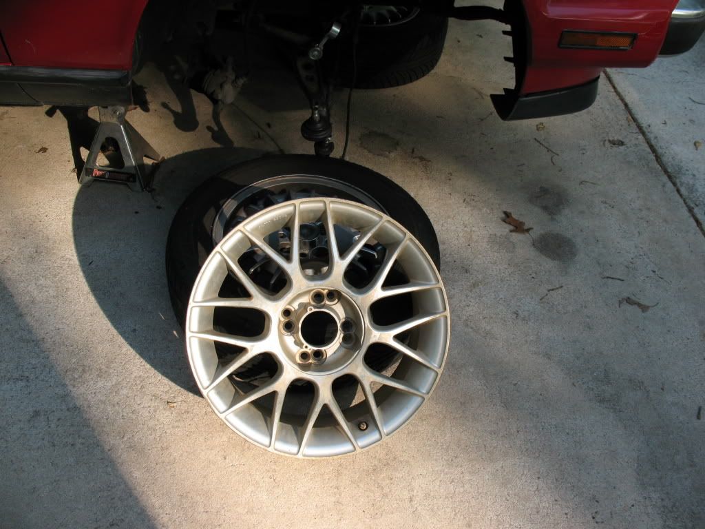

    While looking at different tires, I came across these, which sppear to be very close to what mine look like, except mine has the dual-4 bolt pattern, different lip and more rounded openings around the spokes.

      I know I'd be VERY nervous about running those wheels.

          Because of how little space there is in-between the redrilled holes, and the one set is seriously close to the hub.

            That is how they came, it wasn't drilled out by someone. I'm quite sure those are the boxes the wheels came in, and it says bolt pattern 8 x 100/114.3mm.
            Does anyone have info on them?

              What it means is there is one set of 4 x 100 holes and one set of 4 x 114.3 holes. It's very common for low end wheels to have dual bolt patterns.
              Usually they space them out so there is close to an = amount of space in between all 8 holes. I have no idea why they would have done it that way.
