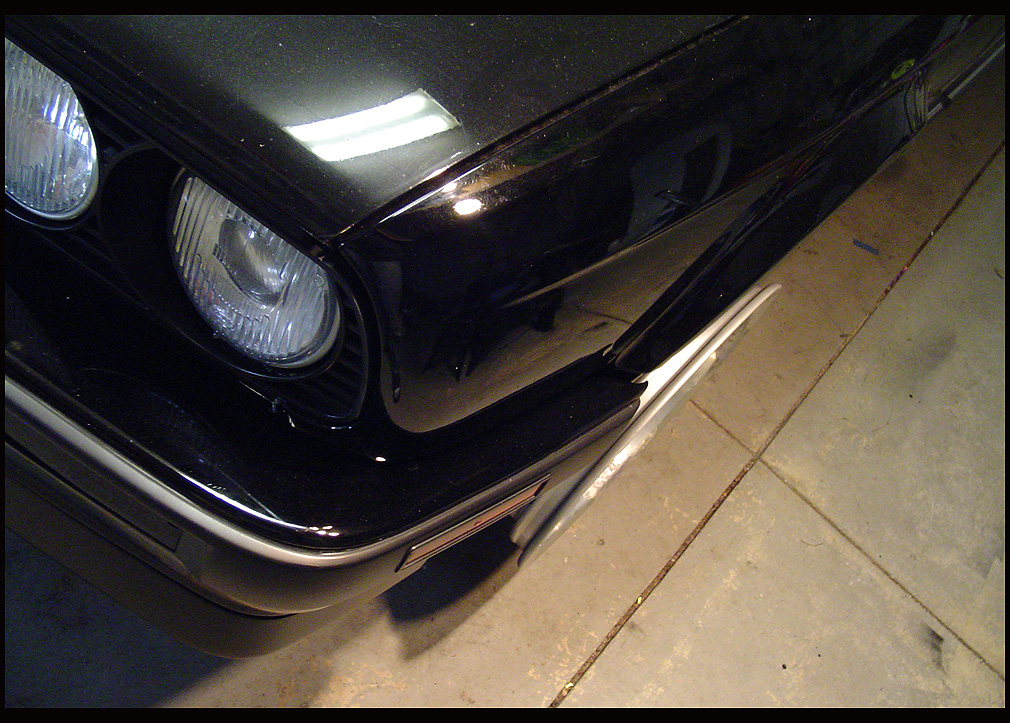

The first mockup. These are just sitting on the hub, the car is lifted on jackstands, and I just wanted to get an idea of where they sit without the adapters. Right now, the edge of the lip is right about 1/2" inside of the fender. It would probably be further in if the suspension wasn't unweighted.

Going to be using the 4x100-5x120 adapters from Rob.

You can't just stretch a tire, bud. Tire stretch depends on the width of the wheel in relation to the width of the tire. I probably will have just a bit of stretch with the tire size I'm going with, since it's a 7.5" wide wheel.

i have the act 15x7.5 and i'm also going with the same et. The fronts sit hella flush with 225s and 2.7 degrees of camber. No rubbing with h&r races and no fender rolling.Your signature picture has been removed since it contained the Photobucket "upgrade your account" image.
