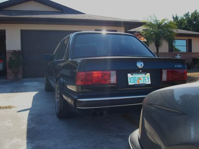

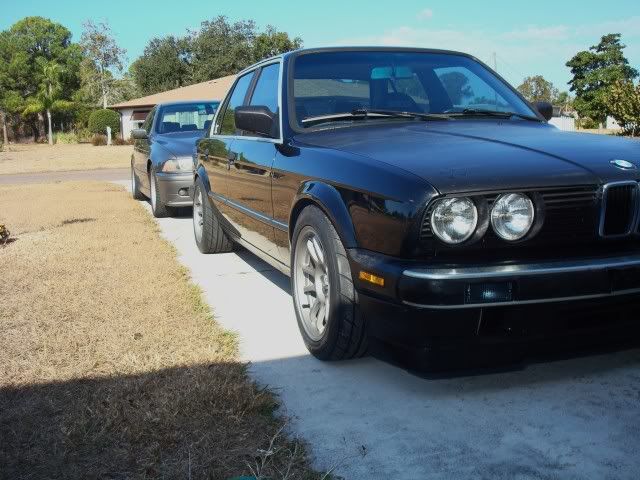

                          225/45/15 fit great on my early body. I've even got a 5mm spacer on the rears.
